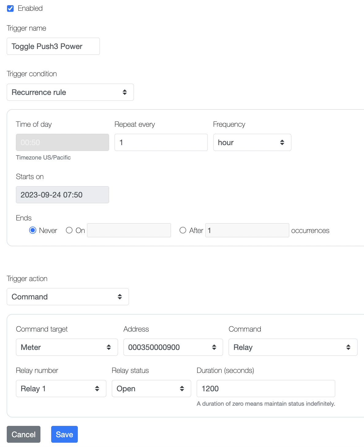

Yes, that should work. When the Push3 is unpowered you could still read your Omnimeters with the USB converter. You could play with the timing of the outage to find something that would work for you. You could even use the Omnimeter Pulse v.4 and the EKM Push3 trigger function to run the timing. Just look into the Recurrence Rules to setup scheduled triggers. You could say every hour at xx:50 turn the EKM Push3 off for 20 minutes for example. You would just control the relay output of the Omnimeter to open for 1200 seconds in that case.
