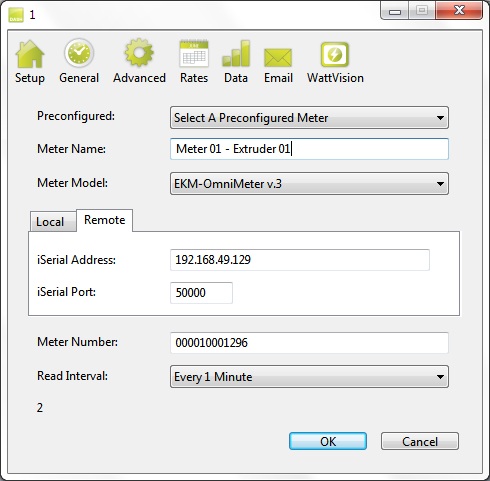

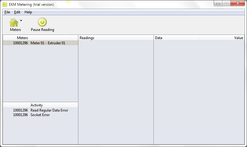

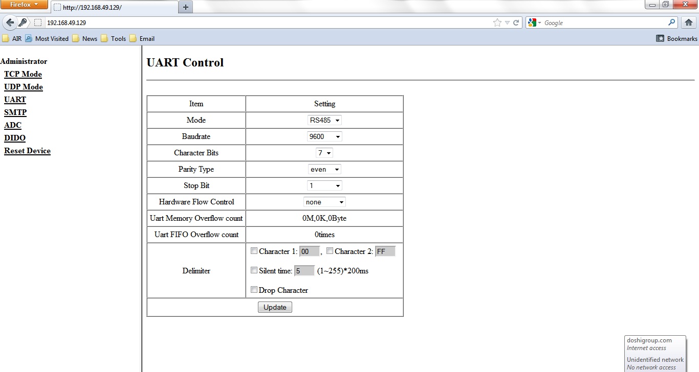

Please find attached the screenshots of the UART Setup screen, the EKM Meter setup and the EKM Dash. I will post the images of the physical wiring as soon as possible.
Vishal
Vishal
- EKM Dash
- EKM Dash.jpg (46.75 KiB) Viewed 54527 times
- EKM Dash Meter Setup. Meter number is 000010001296
- EKM Dash Meter Setup.jpg (56.69 KiB) Viewed 54527 times
- UART Settings on the iSerial
- UART Settings on iSerial.jpg (121.22 KiB) Viewed 54527 times

Re: iSerial Read Data Error
Thanks for your input Bill, it is very much appreciated. Would love to get some dialogs going on the forum.
I am not seeing a glaring issue in the setup of the EKM Dash or the iSerial that you have sent. It is set to once a minute which will make the setup a little harder.
I would try setting the Dash to read your meters "As fast as possible" for a while. This will read your meters once a second. The ACT light on the iSerial should flash once a second (once for every read). Let us know if the ACT light does not flash.
The settings that you show in your iSerial look good. Besides changing the IP address in the iSerial, are there any other changes that you made? Is it still set to be a server?
I will be interested to see the photos of how the RS485 data wire is connected.

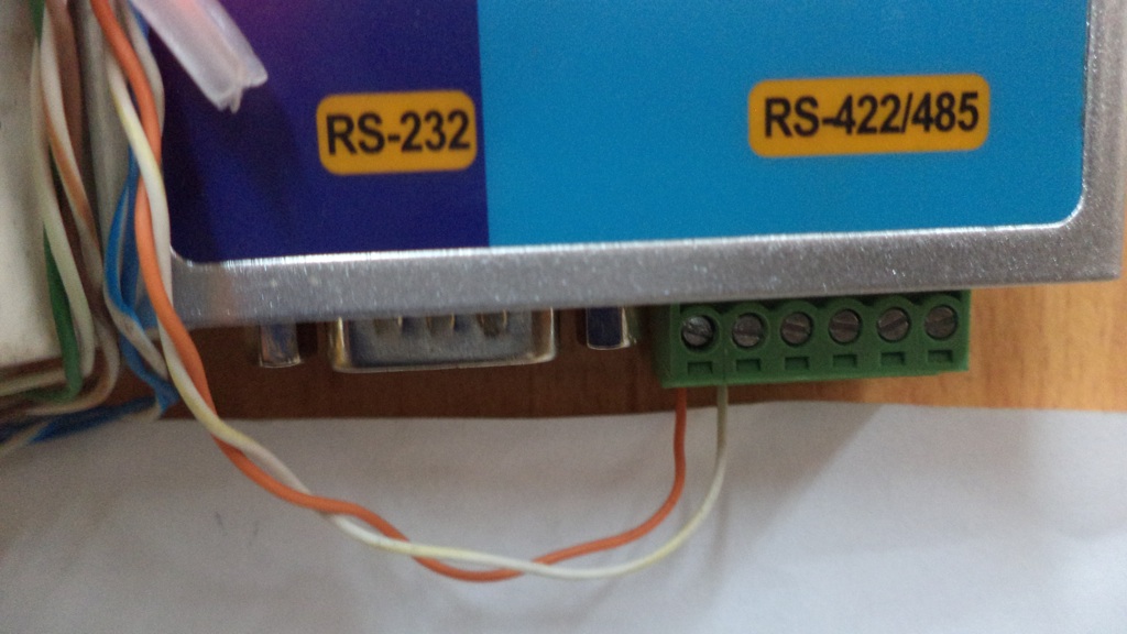

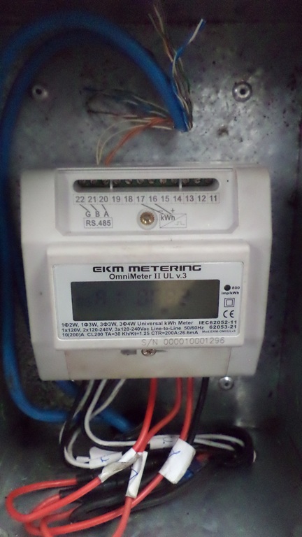

Hi Guys,
Thanks for your comments. I'll try terminating all the meters are the iSerial device and I'll try increasing the meter reading to "as fast as possible". In the mean time, attached are some pictures of my physical connection.
Just a note, the distance between the iSerial device and the first meter is approximately 12 meters. Would that cause a problem?
- iSerial Device connection from Meter 1
- 1DSC00862.jpg (150.01 KiB) Viewed 54512 times
- Meter 2 connected to Meter 1
- 1DSC00858.jpg (143.18 KiB) Viewed 54512 times
- Meter 1 connected to iSerial Device and Meter 2
- 1DSC00854.jpg (94.35 KiB) Viewed 54512 times

Hello Vishal,
From the photos you have posted, it looks like you have the meters and the iSerial connected correctly (assuming you have good contact between the terminal blocks and the twisted-pair wire.) To make sure you have a good connection, it is best to back out the terminal block all the way, then insert your bare wire, then tighten the terminal block screw back down.
We would still like to know if the ACT light is flashing on the iSerial. If it is not flashing the problem is before the iSerial. If it is flashing once a second (once per read) and your meters are not being read, then the problem is after the iSerial on the RS485 side.
