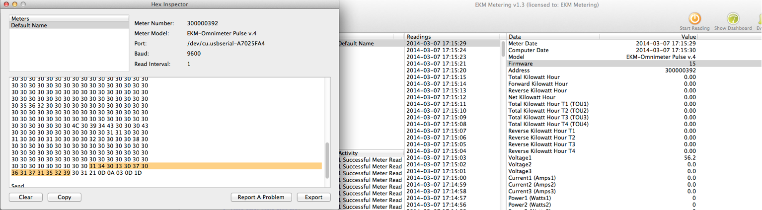

Meter Time in Hex.png (373.85 KiB) Viewed 19385 times
Here is the Hex that I got for time on a V4 meter:
31 34 30 33 30 37 30
36 31 37 31 35 32 39
From this I parse 14 03 07 06 17 15 29
06 is the day of the week.
To be honest, Im not seeing it now (though I did spot some other issue where I couldn't set my meter time to anything I wanted). So I will look into this further - Setting time, verifying time in Hex, etc
Here is what I would do first (this assumes a meter connected via USB converter or iSerial), go to Edit Meter > General > Date and Time. Click "Now" and then very quickly click "Set" and enter your password. This is the closest approximation you will get you syncing with your computer time. This worked for me just now, the bug I just mentioned, we will look into.
From what you guys sent me it looks like there is more to this story, is your EKM Dash misinterpreting your data? If you restart the Dash does the problem correct itself? Thanks for any help or any additional information you can give. I would also want to make sure you are looking at the latest read in both the Hex Inspector and in the Data column.
Thanks again, we really appreciate this kind of user involvement and feedback :ugeek:

We have narrowed down what we think could be going on. We have been able to reproduce the issue with a different meter. It seems like the issue is with how the EKM Dash interprets the time of the v4 meter is messed up. No matter what time the v4 meter reports to the Dash, the Dash will display the Day of the Month and the Hours as the same as computer time. For example if the meter is set to March 5th 08:54:32 and the computer time is March 6th 4:42:39, then the Dash will display the meter time as March 6th 4:54:32.
This also messes up your ability to set meter time. I was able to set meter time to computer time, but not to any time that I wanted. Just follow the instructions I already posted here to do this.
This should be an easy bug to fix, we will release a fix with our next update.
