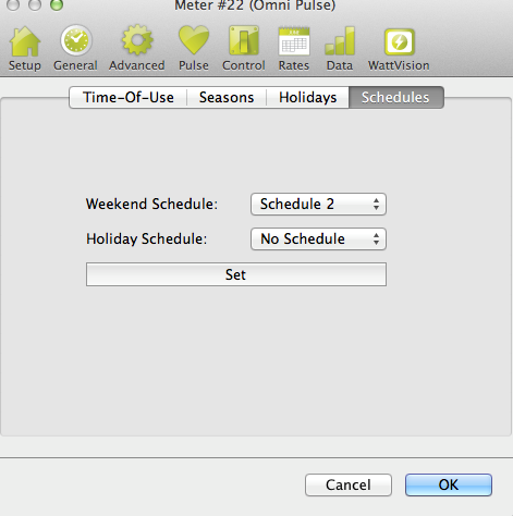

I'm particularly interested in this thread as I have not been able to set up my TOU correctly using DASH!
I can't seem to get my head around how they work in DASH, even following the screen shots Jameson sent me (see below) which I have copied exactly (with the exception of correcting the Schedule 2 rate to Rate 2), I still cannot get anything other than T1 to record the TOU data nor does the meter indicate a T2 usage at the prescribed times on the weekend. The meter TOU registers behave exactly the same on the weekend as they would on weekdays - TOU - T1 07:00 to 23:00 & TOU - T2 23:00 to 07:00
The weekend Schedule is not overriding the weekday schedules as the settings ("successfully set") imply.
When I set the "Rates" Schedules and times and "Set" to save each step, everything indicates that it working correctly - the times are set and the response is that the new settings were successful but this is not translating to the correct settings in the meter for weekend TOU2.
DASH Version 1.4.3.3
Omnimeter Pulse V4, Firmware 15
"QUOTE"
From Jameson:
I would think of this as 2 schedules.
You have weekdays (schedule 1) and weekend (schedule 2)
Give the attached screenshots a try.

Just to reiterate my TOU requirements:
Peak Rates apply between
7am and 11 pm (07:00 to 23:00) Monday to Friday
Off Peak Rates apply at all other times
(So this is between 23:00 to 07:00 on Weekdays and All Weekend 23:00 Friday Night to 07:00 Monday morning)
Is it something I've missed
Edit: "Some misleading and omitted information"

BlueHornet wrote:...I still cannot get anything other than T1 to record the TOU data nor does the meter indicate a T2 ...
P.S.: now I see one detail that's odd, in the screenshots:
You define Rate 1 for On-Peak, and Rate 2 for Off-Peak, including Weekends.
If so, the Schedule 2 screenshot should not show Rate 1, but rather Rate 2.
If it is as on the screenshot i.e. Schedule 2, Rate 1, Start Time 0:01, of course you'll get all energy consumed on the weekend in the T1 count, and none of it in T2

BlueHornet wrote: ... Is it something I've missed ...
I am just guessing, but did you set up a Season? Something like "Season 1, start day 1-January" ? In my case there are three Seasons.
My weekend Schedule looks just as your Schedule 2 - except that I dared a Start Time of 0:00 instead of 0:01 - but that should not matter.

I posted the message in a hurry and realise now that I left out some information that would be important as well as some misleading information.
The T2 schedules that wont work are only for the weekends - in other words the weekend rate continues to behave like a weekday schedule, it appears that the software is not overriding the weekday schedules when weekend schedules are set.
I did in fact change the rate for Schedule 2 to "Rate 2" as I realised that this was an error but this made no difference, the weekend schedules do not get applied and the TOU continues to operate as per the weekday Schedule 1.
I have tried several different Schedule manipulations including those suggested by Jameson, however none seem to to be able to set the weekend rate schedule to my requirements.

Thanks for bringing this to our attention. We will look into the "Weekends" setting and see if there is an issue with the Dash.
It brings up the need to display the meter's day of the week somewhere in the Dash (added it to the roadmap).
Thanks for your help.
