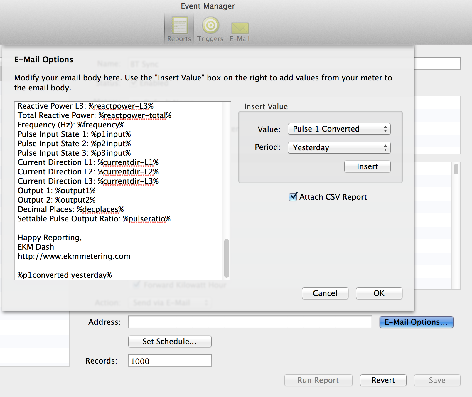

I would play around with the "Reports Email". You can customize the report email by clicking on "Email Options..." See the attached.
Screenshot 2014-11-02 14.22.20.png (380.82 KiB) Viewed 14510 times
You can see how I have chosen Pulse 1 Converted. Im my case it will report as "Gallons" because this is what I have named the Pulse 1 converted value. You can setup the Converted value to be anything you want such as liters, cubic feet of gas, cubic feet of water, car count, Number of People Walking By, etc.
