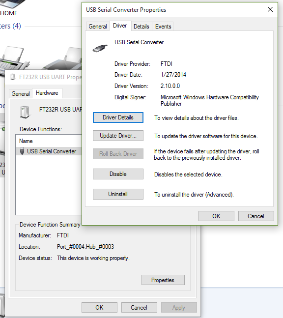

Will you go back to the "location" window and click Properties? Then click Driver (send this screenshot) and Events (send this screenshot too)
At this point I am not seeing why your USB Converter is not blinking once every 5 seconds. Is your Dash attempting to read once every 5 seconds?

Thanks for the additional screenshots of your FTDI driver settings. Everything looks to be in order from everything I can see. You have the exact same FTDI drivers as we have on our Windows 10 machine (same vintage). All messages look like it is installed, running, looking good, good to go, etc.

Im thinking you need to re-install the driver. I dont think this should be too difficult (though I am not PC or Windows 10 savvy)
In the Windows 10 Port section that I took you to before there is a section that has to do with "Updating the Driver"
Screenshot 2016-03-29 17.24.19.png (72.97 KiB) Viewed 36640 times
I did this with my USB Converter connected to my windows 10 machine: Click on Properties > Change Settings > Driver > Uninstall. After this I no longer had a driver on my Windows 10 computer. I then un-plugged my USB converter and plugged it back in. The windows 10 machine then automatically downloaded the drivers again and they worked.
Im thinking there must be something odd about how your computer installed the drivers and by doing the steps above it may give you a fresh start.
