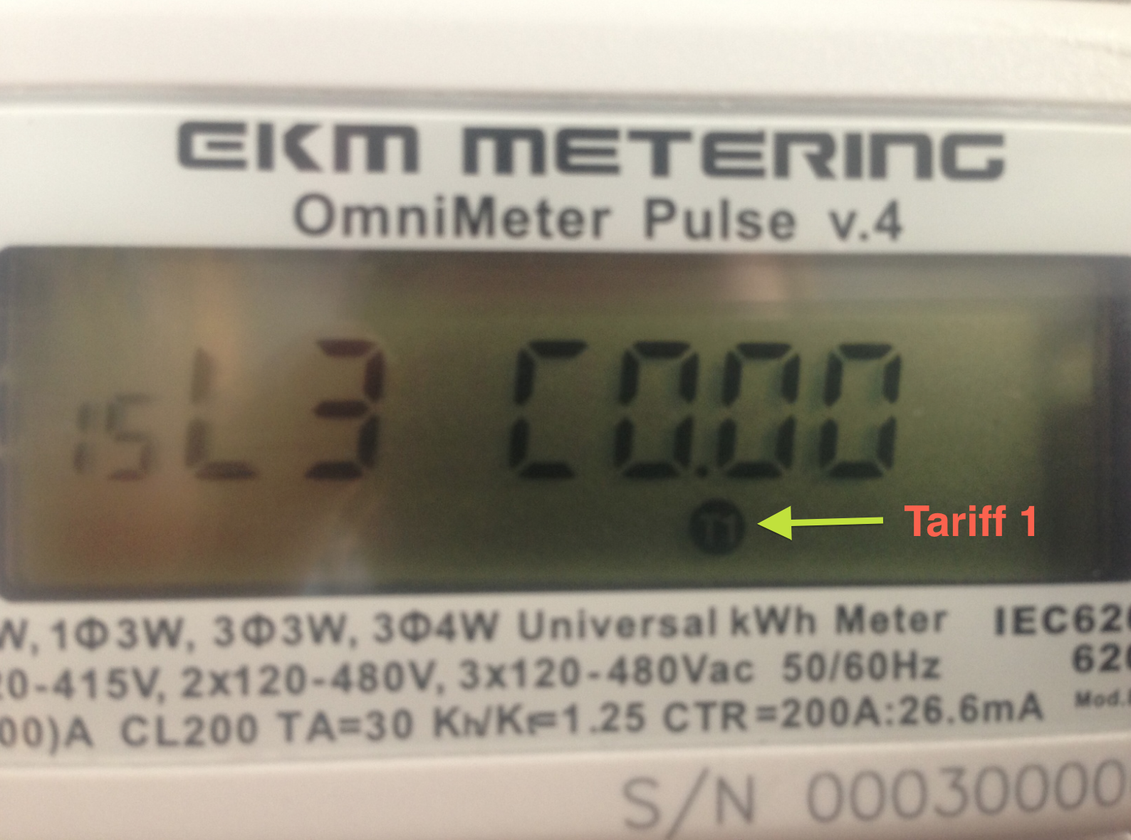

Can you post screenshots of your settings? Do you have the weekend schedule turned on? If you do not have weekends turned on as a schedule I think the meter assumes that there is not a difference in the weekend Tariff (treats all days of the week the same).
One troubleshooting tip to know which Tariff you are in would be to look at the meter face. There is a small black circle that says "T1", this indicates the meter is currently in "Tariff 1". See attached.
Screenshot 2014-08-11 17.05.50.png (1.81 MiB) Viewed 49486 times
