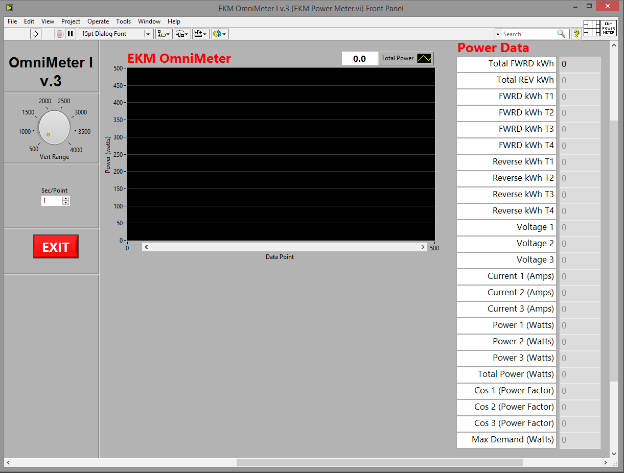

Hi All,
I have developed vis to read data directly from the Omnimeter I. Perhaps it also works with other models.
I took on the project because the OmniMeter is part of a system to get electricity from a modified diesel engine that runs on syngas (Hydrogen and Carbon monoxide). The system automation involves collection engine parameters and power output to optimize the amount of syngas going into the engine and add diesel if necessary. It also collects data from several other sensors to automate the entire system from biomass input, gasification control, char output and engine control. It is a complex automation program I did in LabVIEW thus the need to get and process the OmniMeter data in real time.
Here is a screen shot:
EKM powermeter LabVIEW.PNG (59.67 KiB) Viewed 55895 times
The software is located here: http://documents.ekmmetering.com/LabVIE ... eter_I.zip
The vis were created using LabVIEW 2011
Perhaps someone else can find this useful.
Alejandro Andreatta

Hello Alejandro,
Thank you very much for sharing this with our customers, I have already let a few customers know about this that had inquired about integrating our meters with LabVIEW.
And thank you too, for sharing what you are using the meter data for, it sounds like a very cool project. Please do keep us posted with your progress.
If anyone uses this, please chime in and let us know how it works for you.
