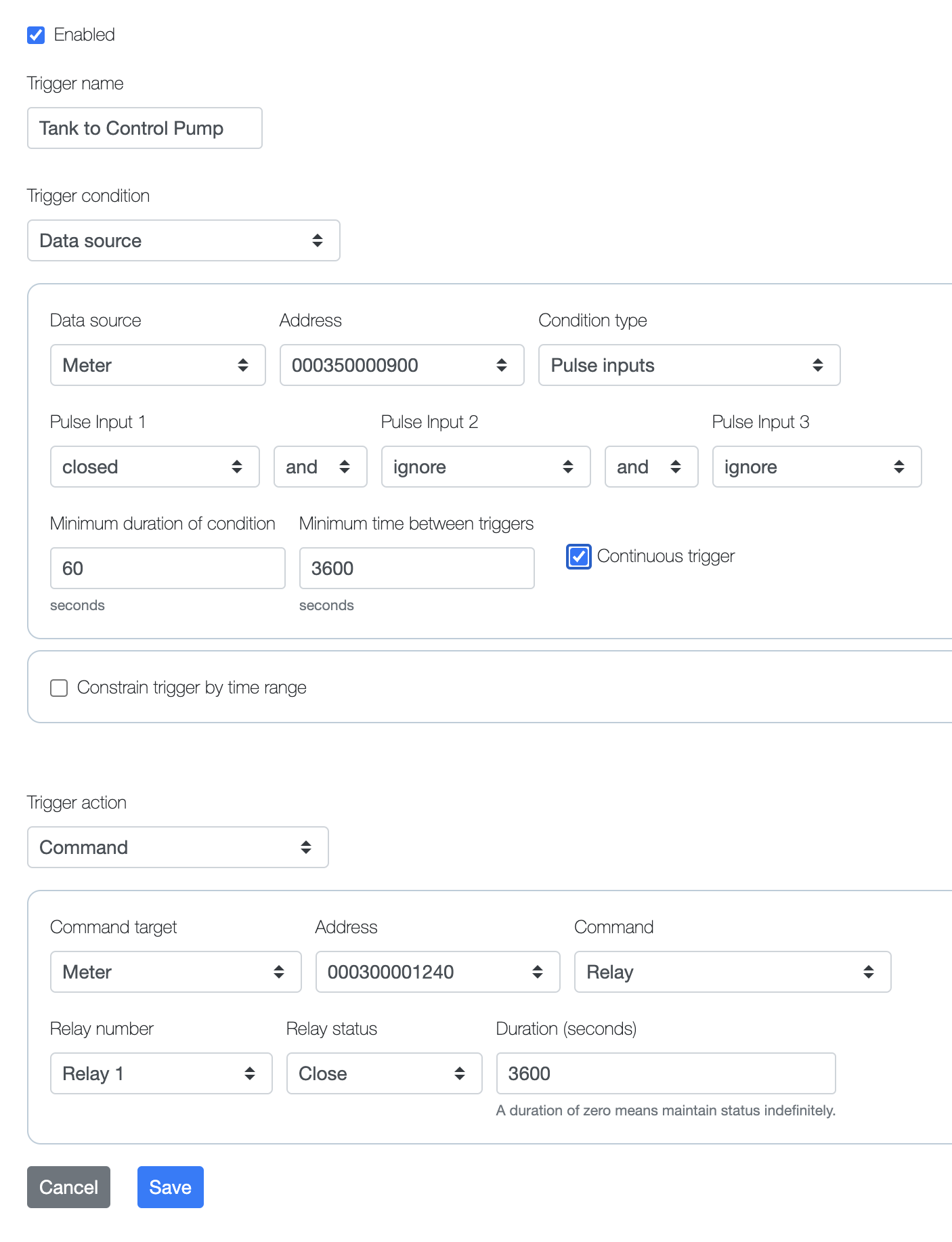

I am trying to find a way to add a simple pump on/off control between a storage tank and a water well to turn a pump on and off. I have a normally open (NO) float switch in the tank and a motor starter at the well head. At both locations, I have v.4 Omnimeters connected to your Zigbee RS485 radios to collect electrical and water meter pulse data back to a central monitoring computer. How would I go about triggering the output on the Omnimeter at the well site from the remote location??? Seems to me there would need to be some way of using a pulse input (on/off or hi/lo) at the tank end and addressinfg a specific Omnimeter's output in the network???

So in summary yes, you could have your Omnimeter near your storage tank be connected to a float switch (connected to one of its 3 pulse inputs), you would then monitor the Pulse Input states and trigger based on their state (see screenshot for an example of a Push3 trigger), you would then control the controllable relay outputs on a different Omnimeter. The controllable relay outputs would be connected to a larger relay, contactor, or solid state relay which would power/un-power the pump.
This screenshot of a Push3 trigger shows how the pulse input state of one Omnimeter can be used to control the relay outputs on a different Omnimeter:
