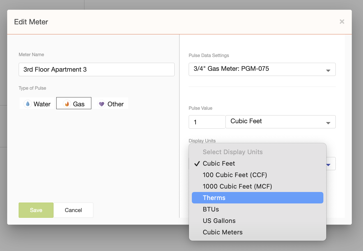

Another question:
I have this gas meter:
PGM.75 #40 3/4 Inch Pulse Output Gas Meter - PGM-075
and it says it outputs " 1 Pulse Per Cubic Foot".
The gas bill is in Therms.
Can I just change the widget to therms and It will do the conversion?

Hello Oz,
Yes, you should be able to select Therms for your "Display Units" for your gas meter, this is behind the Meter Settings tab in the www.encompass.io interface.

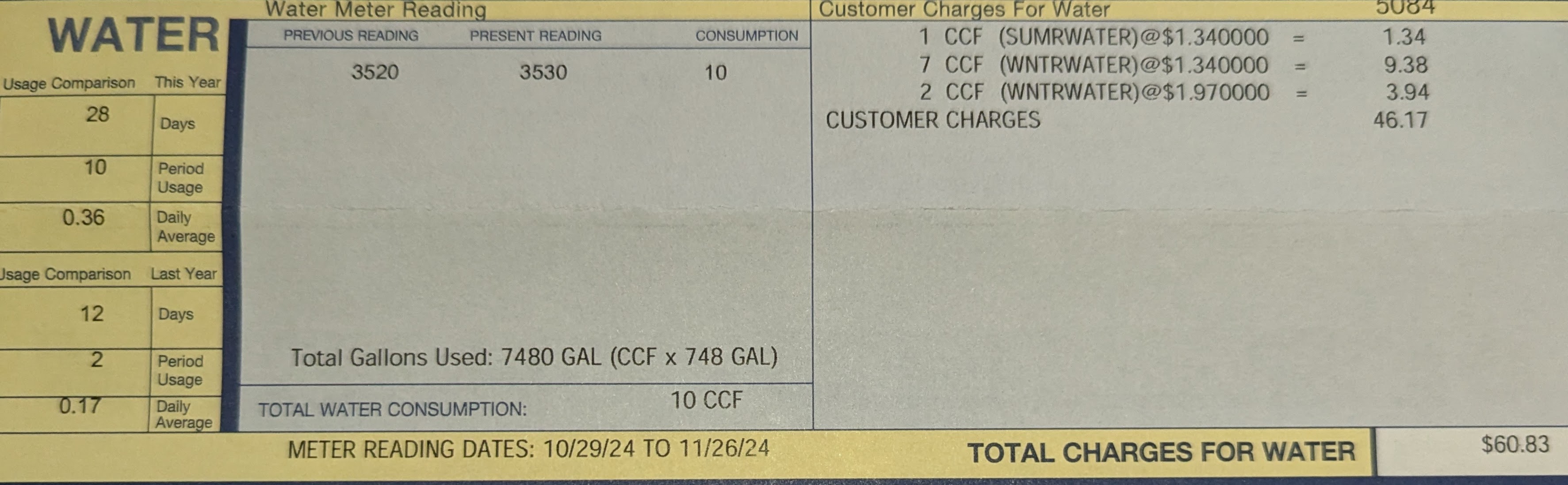

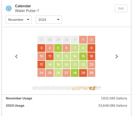

I am having a couple of issues:
I have a duplex and get the single water bill for both units, then I have the pulse meter reading just the rear unit.
The problem is, the rear unit is reporting more than the total reading on the bill (see pics).
Water bill reported 7480 gal total and pulse meter reported 7832 gal for just the rear unit.

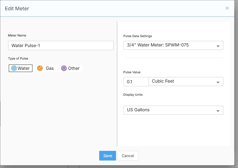

I would make sure that the start date and end date that your water utility read your utility water bill was exactly the same as your EKM water meter was read.Water bill reported 7480 gal total and pulse meter reported 7832 gal for just the rear unit.
You will also want to be sure encompass is converting each pulse into 0.1 cubic feet if this is your water meter model: SPWM-075 #39 3/4 Inch Water Meter

The issue I still have is:
Water bill shows 10CCF and new data adjusted pulse readings shows 9.7CCF for the rear unit.
Front unit has 2 adults and one 16yo,
Rear unit has 2 adults and 2 under 3yo kids, and is using ~97% of the water.
Thoughts?

Please explain what the issue you are seeing is. What are you seeing on the EKM water meter and what would you expect to see?
Is the EKM water meter only connected to the rear unit and is only measuring what the rear unit is using?
What dates did the water utility read their meter? Which dates are you using for the EKM Water meter?
Which EKM Water meter model are you using? What is the value per pulse that you have entered into encompass?
Keep in mind that water meters do not generally fail in such a way as they would measure too much water, they only fail in a way that they measure too little water. Sounds like you are thinking your city water meter is measuring too little water, is that right?
Have you run a test to see how the city water meter and the EKM sub water meter compare? Turn off the water to the main house, run only water in the back house. Run something like 5 cubic feet or more of water then stop and see if both meters agree.

Even after I adjust the start/stop meter read dates, its showing the rear water use is 97% of the total water used.
And as I explained, there is 3 people in the front and 4 in the rear (2 are toddlers) unit. The numbers just dont add up.

SPWM-075 #39 3/4 Inch Water Meter - Stainless Steel, Pulse Output (see default settings in pic)Which EKM Water meter model are you using? What is the value per pulse that you have entered into encompass?
