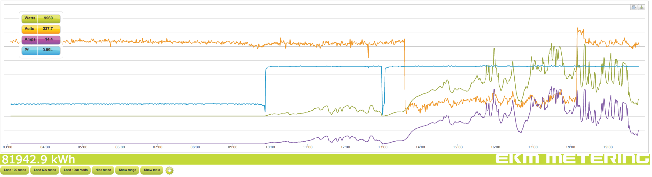

I would go with the Omnimeter Pulse v.4 for your solar system. Mostly because (in addition to all of the other parameters the Omnimeter I v.3 reports) it reports the direction of current in real-time. So if you were to locate this meter between the building and the grid, the meter would tell you if you are importing or exporting power on each line in real time.
I would then use the EKM Push system and export your data (or your customers data) to pvoutput.org: http://www.ekmmetering.com/pvoutput so you can compare and compete with a bunch of people all over the world (mostly Aussies)
Or you can use the widget or encompass.io to view your (or your customers) data from anywhere in the world, it would look similar to this:
Screenshot 2015-01-15 19.49.57.png (155.07 KiB) Viewed 101469 times
You can use the EKM Dash software to monitor your system and for example have it send you an email if a system has been underperforming for a few days (using Triggers).
Depending or where you are installing and the size of your systems, you can then use your metering system to get SREC credits, credits through California Solar Initiative, or LEED credits.
