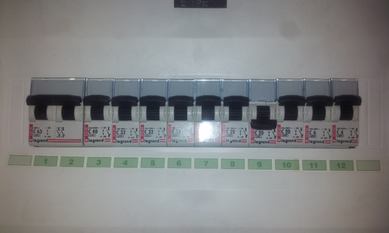

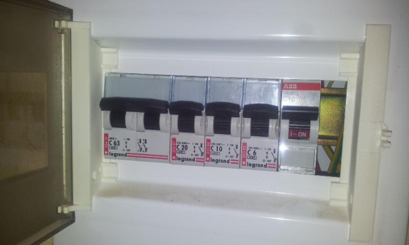

I live in Cyprus and I have single phase 240v. The inverter has a cb in subboard. The subboard has a cb in main board.
Re: EKM Metering systems for solar PV?
photos attached of main and subboard
- subboard cb is the number 4
- main.jpg (170.06 KiB) Viewed 331715 times
- inverter cb is the last on the right
- subboard.jpg (177.91 KiB) Viewed 331715 times

The solution for your circumstance would be along these lines.
1 EKM V4 to monitor the main board with a CT on the main line (import / export) and a CT on the sub board line, this will give you total import from grid and export to grid.
1 EKM V4 on the sub board, 1 CT to measure consumption in the garage, 1 CT on the inverter will give you generation.
1 iSerial.
You will be able to daisy chain the two meters with twisted pair wire that should fit in the tubing you already have or run along side if unable to.
An easier (and possibly a cheaper) way might be to run the inverter wires back to the main board, this would mean that only 1 V4 with 3 CT's is needed, this would be a more preffered solution.
MeterMan will give you total import. export and consumption, uploads to PVOutput will give you energy generated, energy used, energy used in this case is the total energy used from import + energy used from self generation.
It will also give you a cost analysis based on tariff import charges, savings from self consumed and income from generation.
Using a V4 will also remove the need to upload generation from the inverter seperately.
Cheers
