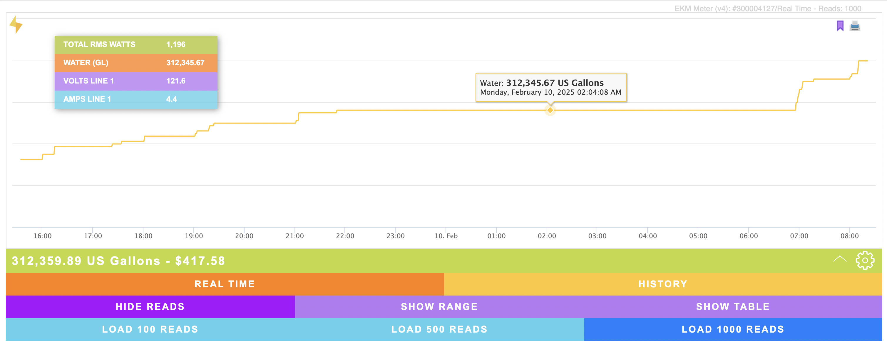

It sounds like you may want a real-time line chart that shows the water meter flow rate. Does that sound right? At this point we do not have a great way to do that. The closest we have is the EKM Widget setup to show the Pulse Count as an always rising line chart of the Pulse Counts.
Here is an example: https://widget.ekmmetering.com/EKM2/?re ... _lines=341
So far we do not have real-time pulse count data in encompass.io. The always rising nature of the pulse count data would be confusing to some. But someday we would like to be able to have a line chart that shows the pulse rate instead. This data is only available from the EKM ioStack pulse inputs, not the Omnimeter Pulse v.4 inputs.

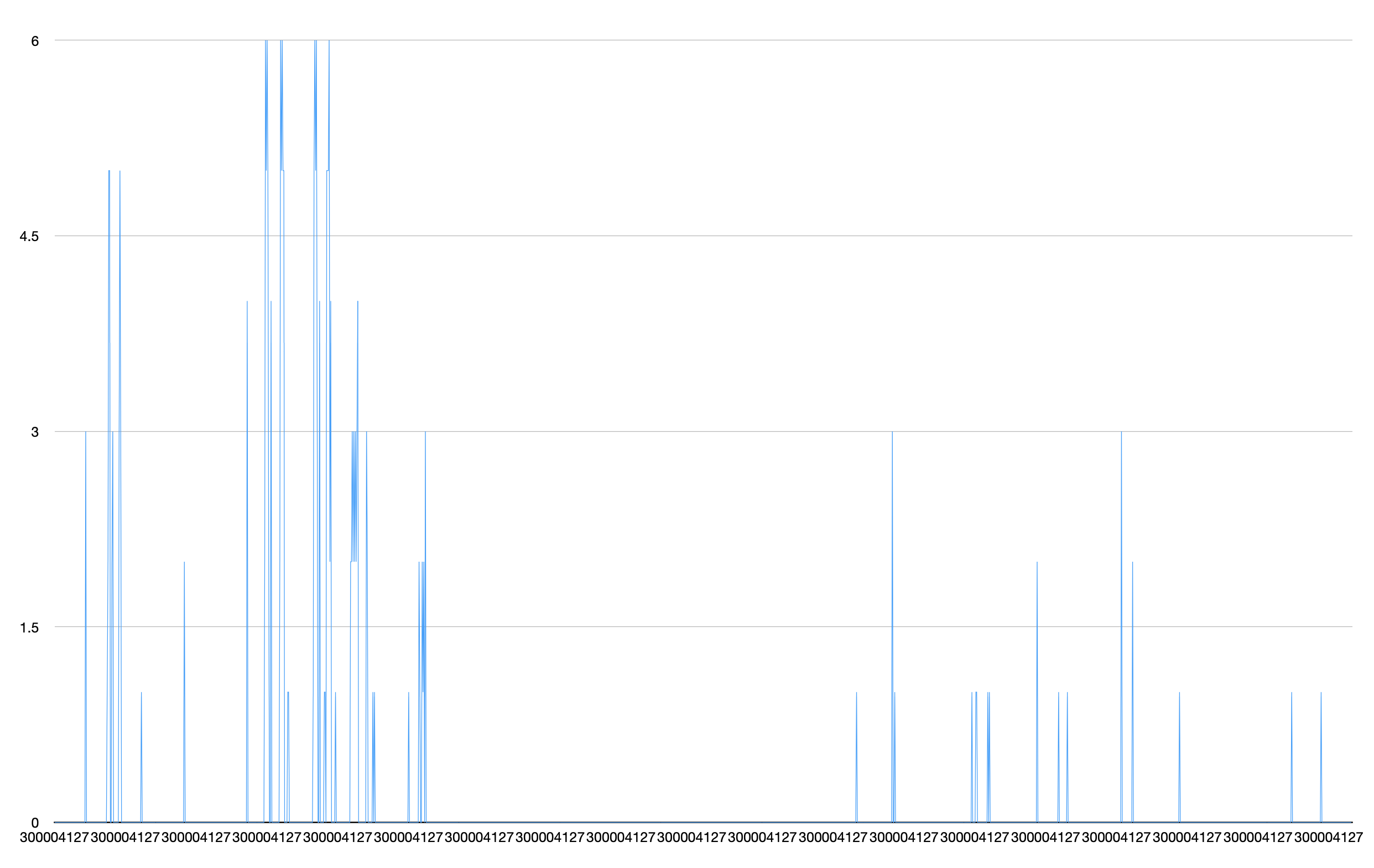

Thanks, I think your idea could work if there were always multiple pulses per minute (maybe in the case of an electric meter for example). But in most cases for water meters the pulses per minute are zero or usually zero (particularly if the water meter is a non-HD model). So that is the issue that is tricky to get around.
Here is a real-time csv file for the EKM Widget that I posted earlier. It is for the latest 2000 1 per minute reads, the max pulses per minute is 6, the average pulses per minute is .139 pulses per minute.
https://api.ekmpush.com/readmeter?key=M ... 0300004127
If I chart the data as pulses per minute it looks like this (newest data on the left). I find it difficult to extract much value from it: Let me know if you have any ideas! We always appreciate them.

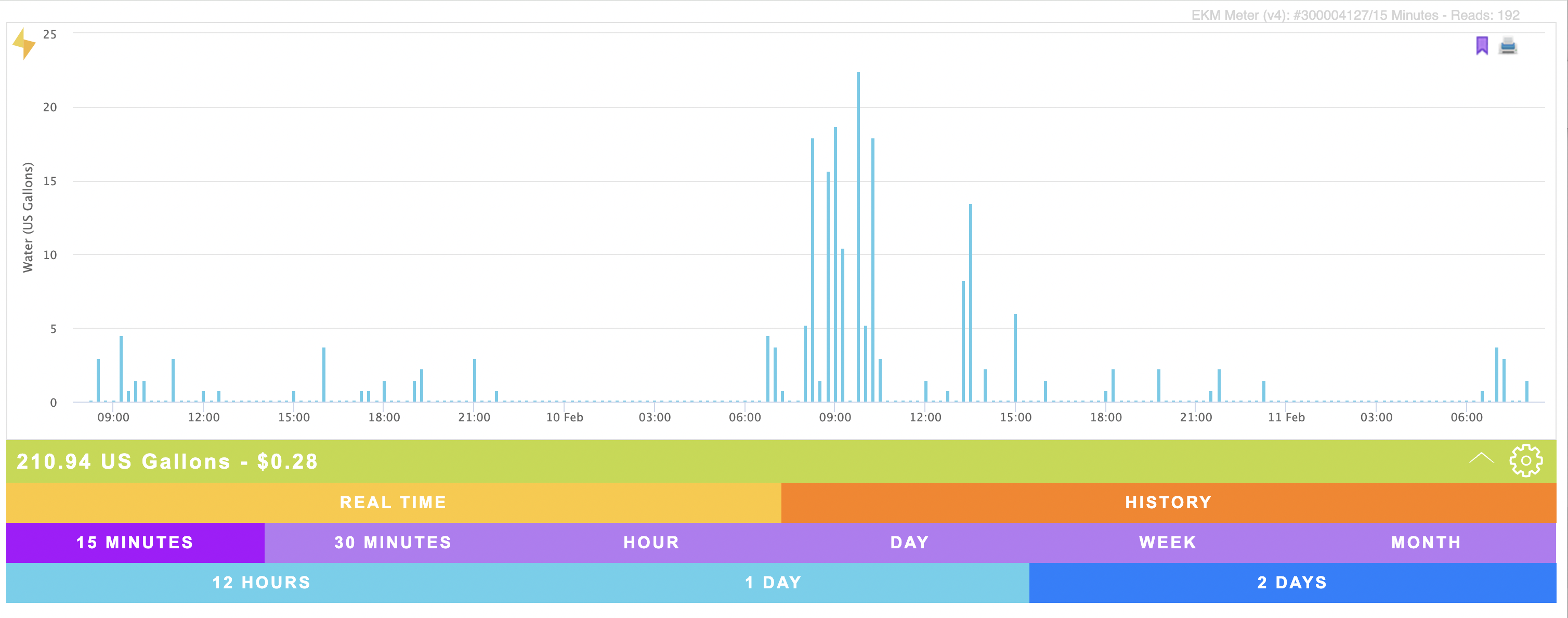

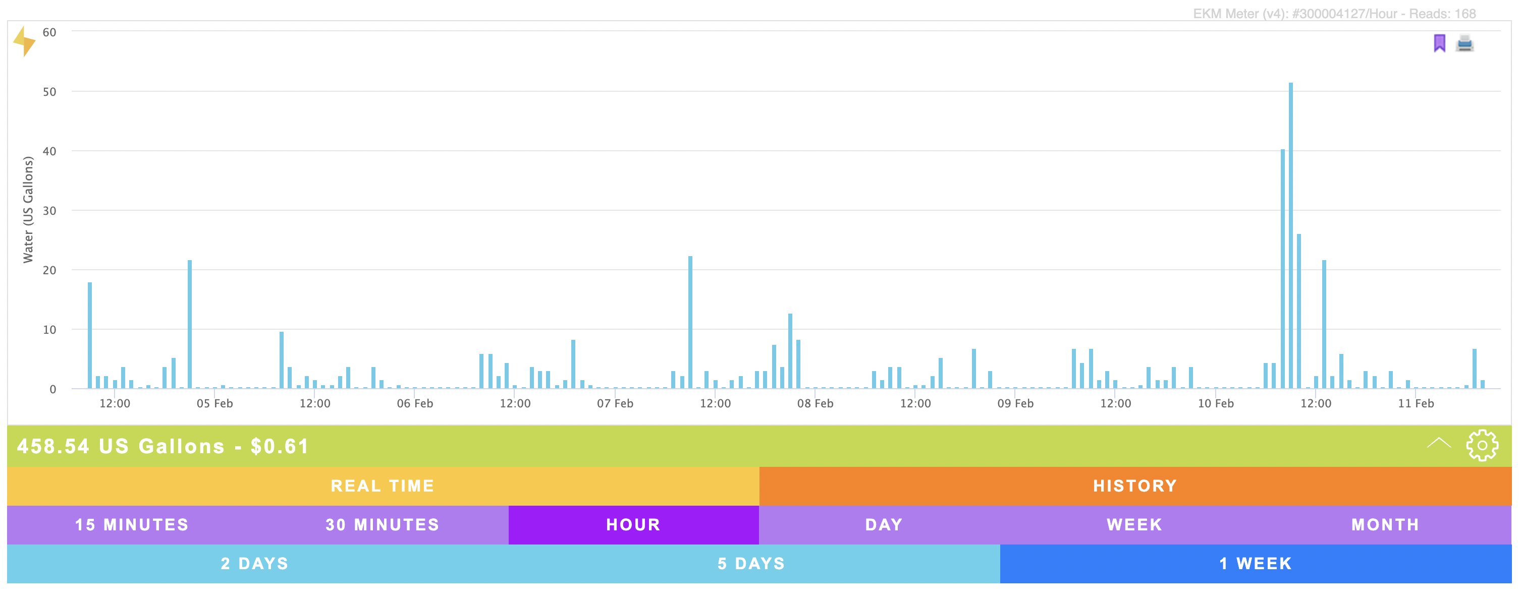

For water meter data we tend to look at the 15 minute or hourly data. Its usually enough to let you know if there is an issue (a leak, unexpected usage, or an issue with the pulse counting)
Here is what 15 minute data for 2 days looks like:
Here is what hourly data for a week looks like:

Actually, those 2 views of pulse data (as bar charts) are quite useful. Please consider adding those to the Encompass.io dashboard widgets for Pulse meters, including the ability to expand the widget full-width, the way the Electric kWh real-time widget is. Also make it possible to manually-adjust the time slicing to 15 mins, 1 hour, 2 hours, 6 hours, and 24 hours.
