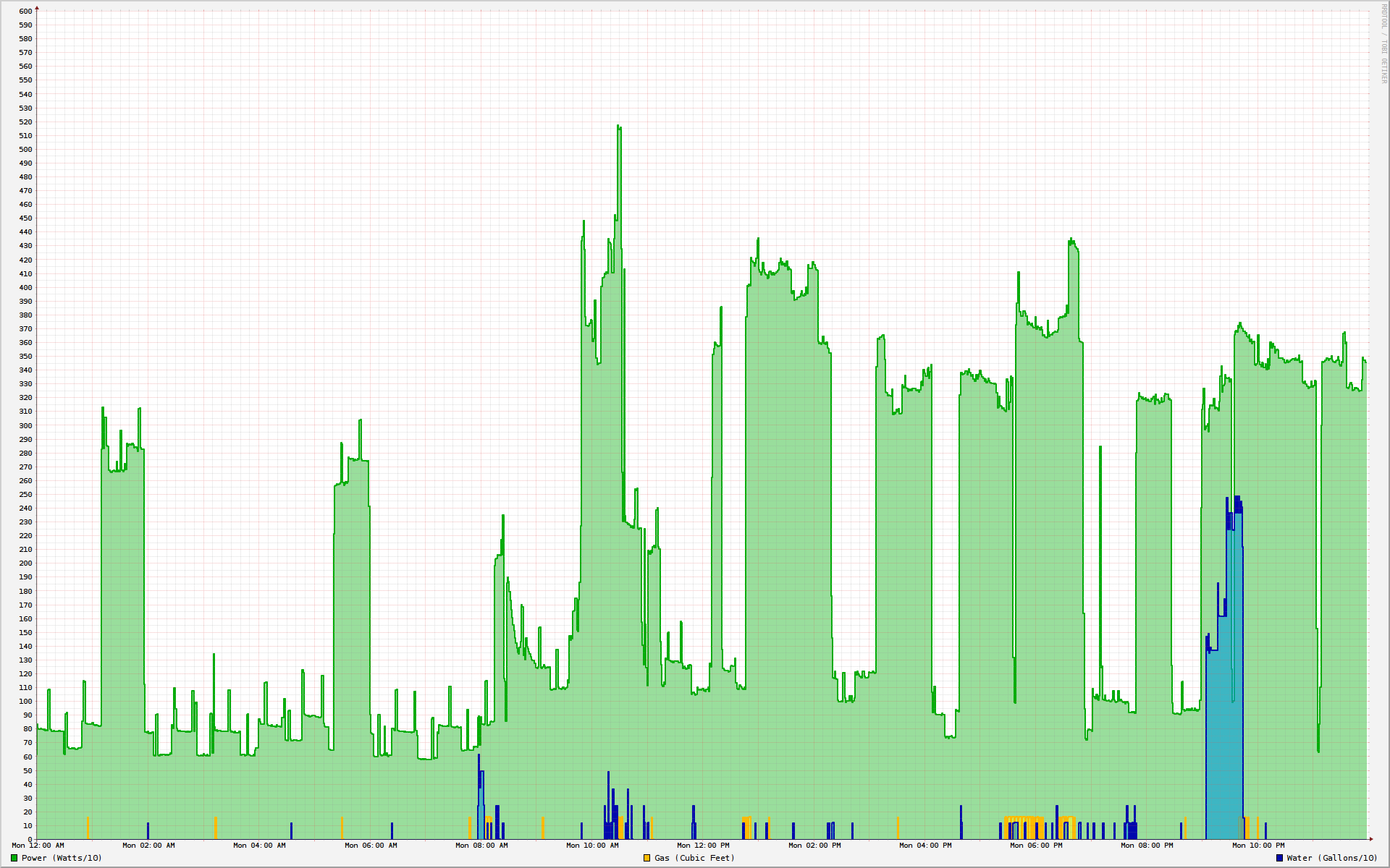

Wow, it's been a while. I've been running this for several years now, but my house had a direct lightning strike back in the fall and it killed my meter, as well as the Raspberry and a lot of other equipment, despite my diligent grounding and UPS usage. Then today I ran across this post.
Here's what I've been using; I'll have to pull the code back out once I get the meter replaced this spring.
You can see when the AC cycles off and on, the refrigerator, when someone takes a shower or washes dishes, and in the summer when the grill is running.
