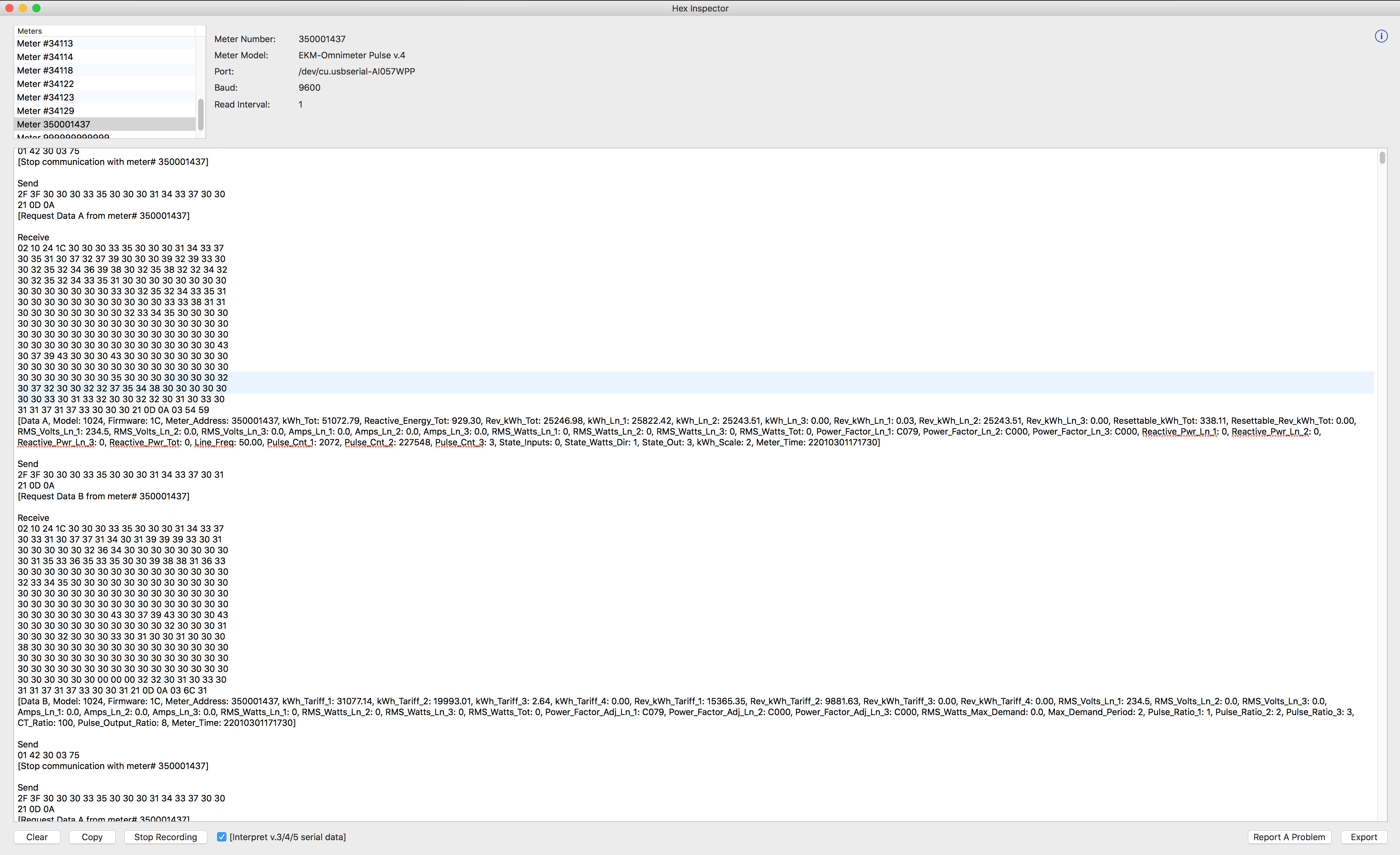

Re: How to Get Water and Gas Data from Omnimeter
Here is a screenshot from my EKM Dash Hex Inspector. It shows an example of an Omnimeter Pulse v.4 Read A and a Read B. I have highlighted (in faint blue color) the section of the Hex that is for the Pulse Count 1, Pulse Count 2, Pulse Count 3. The Hex for this section at this moment is 30 30 30 30 32 30 37 32 30 30 32 32 37 35 34 38 30 30 30 30 30 30 30 33. You can see that the Hex inspector also parses out the data (to help teach you how to parse the data yourself), the parsed data says: Pulse_Cnt_1: 2072, Pulse_Cnt_2: 227548, Pulse_Cnt_3: 3
