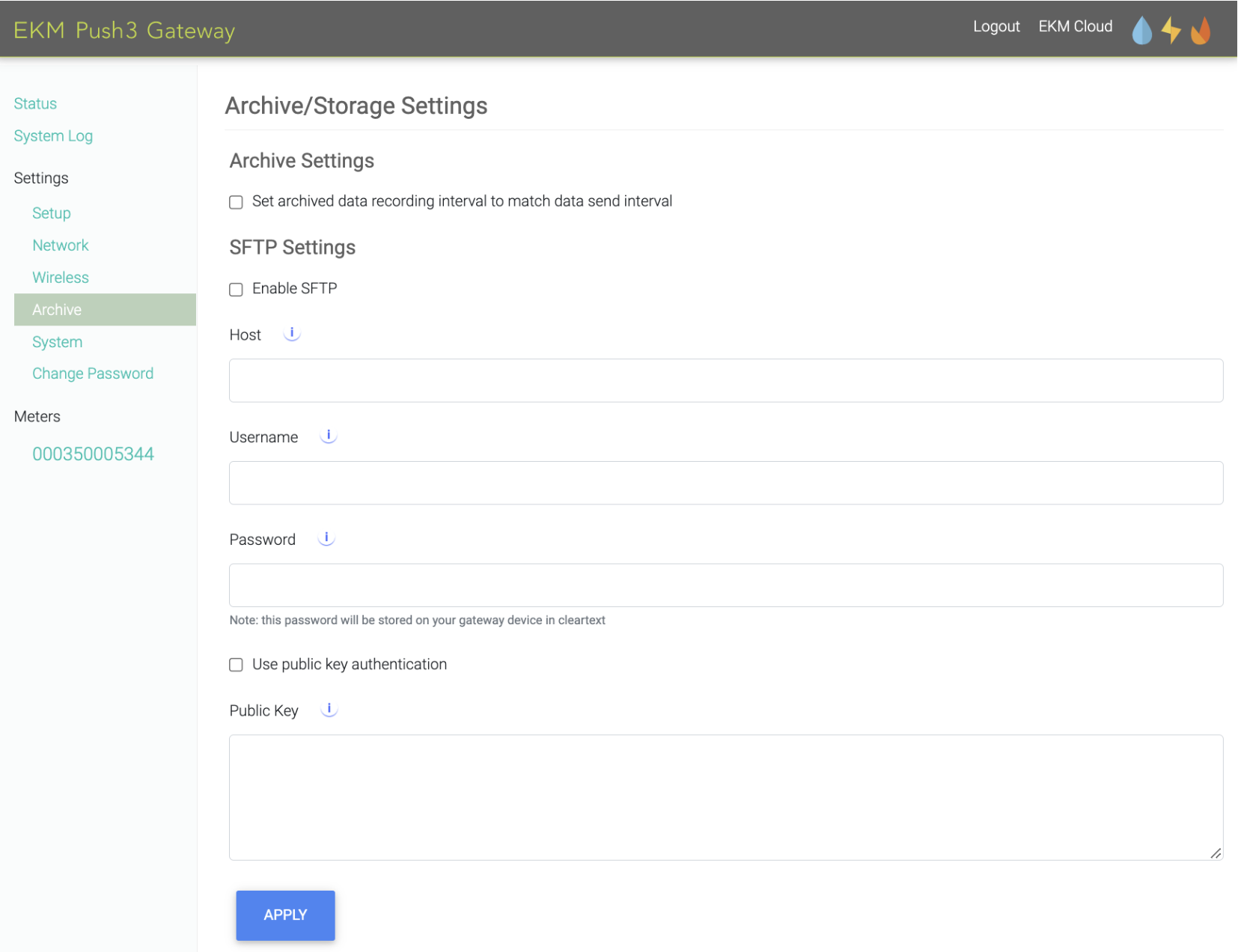

Re: EKM Push Summary API
Yes, you can set your Push3 to send meter data to your own server via SFTP, we can set it so that it will not send meter data to our own EKM Push servers.
With SFTP, you can setup your gateway to securely send real-tme data and 15 minute summary data to your own cloud servers. This could be your own servers at AWS, Azure, etc. You can setup your Push3 gateway to send either every single meter read (once per second in most cases) to the cloud, or you can "Set archived data recording interval to match data send interval” (which is the once per minute interval Push data is sent to our EKM Push servers by default). All you need to do is:
Log into your EKM Push gateway web UI
Check Enable SFTP
Give your Host SFTP url
Provide your Username and Password
And if you want to use a public key, you have the option to provide this as well.
Click Apply
The meter data and ioStack data will go directly to your servers. You can have EKM make a setting in the EKM Push backend, so the meter data does not go to EKM Push servers if you do not want it to. Or you can have it send to both your own SFTP server and the EKM Push server at the same time.
Screen Shot 2025-01-29 at 3.10.21 PM.png (189.43 KiB) Viewed 174938 times
