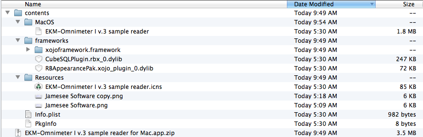

Thanks for posting the demo link. I may be missing something but so far am unable to open it on a Mac. Do I need to open it through xojo? (I only have RealBaisc on this computer)
I will attach a screenshot of the "Contents" I get when I unzip.
Screenshot 2014-08-25 09.59.46.png (72.54 KiB) Viewed 26818 times
Thanks again!!

Hi Jameson
You shouldn't need any Xojo or RB software. This is an application file/package so you should be able to just put it on your Mac and double-click to launch it. (I think you can also launch it by double-clicking on the Omnimeter file in the Mac OS folder - but that's a rather round about way to go).
Hope this helps.
All the best.
jamesee
Re: Here is how I am calculating crc16
:oops: Im still not able to open this. When I try to open the file "EKM-Omnimeter I v.3 sample reader" on Mac OSX 10.8.5 it opens my Terminal program and then stops. That is all I see. As far as I can tell your software does not start on this computer.
Please double check the file "EKM-Omnimeter I v.3 sample reader" that you have in Dropbox.
Thanks for your help!!
