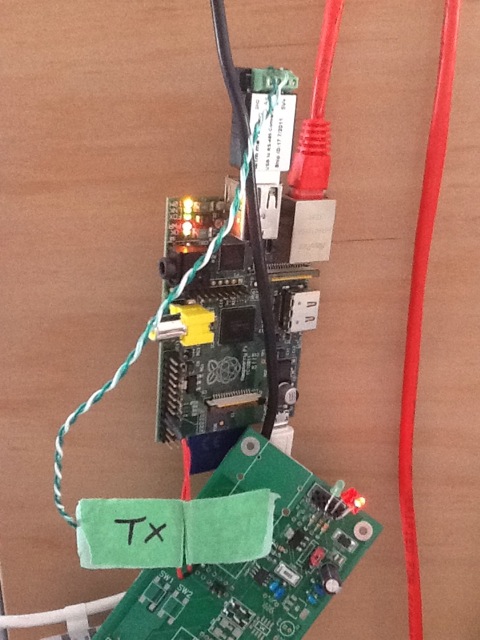

Above : A little less related; a Pi with a TTL->RS232 level shifter attached and that in turn attached to a USB-RS232 converter.

My RasPi:
TTL UART (Im a beginner at this stuff): I connected an RS485 transceiver to the RasPi TTL UART. We were able to sniff the serial output of the RasPi on one of our RS485 converters (came through clean). I have not been able to get the serial settings on the RasPi to be the right ones to read one of our meters yet. The attached image (of our RasPi at EKM) shows the UART connection. The board it is connected to at the bottom, is a scrap board that I used to power the RS485 transceiver.
I could download the FTDI drivers to the RasPi and could see the USB converter was connected, but never got it to work.
