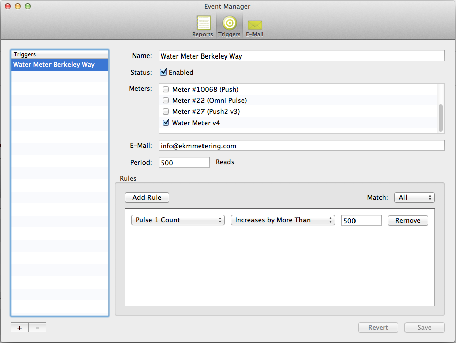

Thank you very much for your posts Dandelot, and for explaining where you got stuck and how you fixed the issues.
Any way you can send us a screenshot of what you were seeing here:
If you are interested in Triggers, you can set them up by going to EKM Dash > Events > Triggers
Here is a trigger I have setup to send an email to info@ekmetering.com, it happens if the v.4 Pulse 1 increments by more than 500 within 500 reads (500 minutes in this case). This one is looking for a lot of water over a fairly long amount of time (a size-able leak, or a lot of irrigation water), you could set it up to look for less water over a shorter period of time (a broken pipe). It will take some experimentation to setup various triggers that will be most useful for you. :
