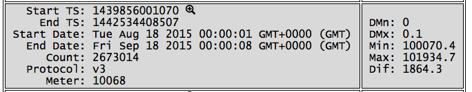

Re: EKM Push Summary API
Say for example that you get billed on the 18th of each month, so you want to know your electricity usage or water usage from the 18th to the 18th of the following month. In this case you can use report=mo18
http://summary.ekmpush.com/summary?mete ... 8&limit=10
This will return kWh data for up to the last 10 months from the 18th to the 18th. Here is one record out of 10:
This is the summarized data record based on 2,673,014 real-time meter reads from v.3 meter 10068 from August 18th 2015 to September 18th 2015, filtered for kWh_Tot only.
If you want to know the usage for this period of time you can look at Dif=1864.3 (in the screenshot above). This means that from August 18th to September 18th this meter measured 1864.3 Total kWh. (the kWh read at the end of this period of time was 101934.7, the maximum forward increment of this time period DMx was 0.1 kWh)
Hope this helps,
Hope this helps,
