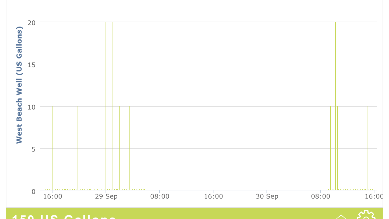

It looks like things were fixed sometime shortly before noon today, although as the following graph from the Widget shows, about 26 hours worth of summary data were simply never generated, from roughly 7am on the 29th to 9am on the 30th. Bummer. Our meter only spits out a pulse every 10 gallons, so the data appear rather sparse, but if you look at the bottom of the graph, you can see little tick marks where the 0's are, and even these 0's are missing for about 26 hours, indicating no records. I checked the realtime data many times during this period (the URL in my original post), so I know my Push was sending data and the pulse counts were incrementing.
At this point I'm prepared to conclude that there was some back end outage that caused the summary data to not be generated for more than a day, but it would still be good for my sanity to have some validation. ;)

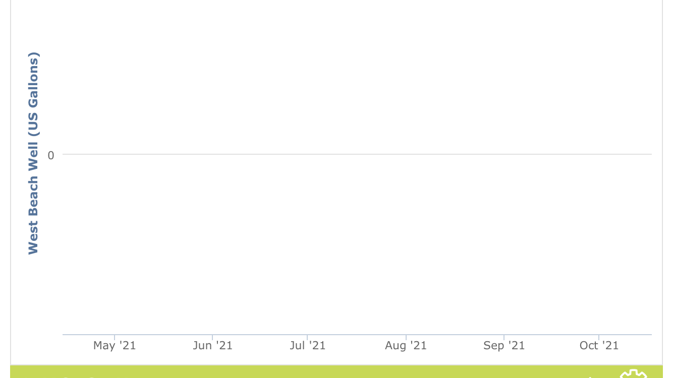

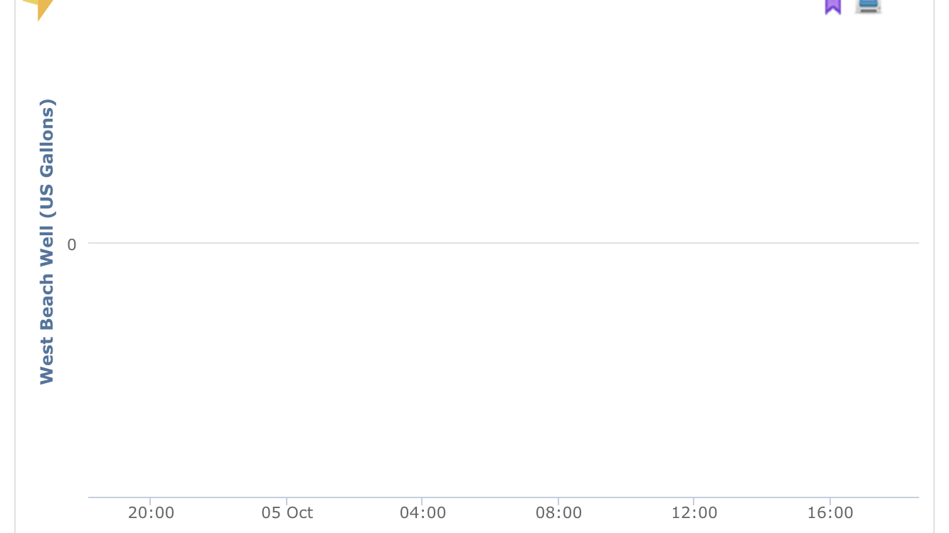

Hmm. The summary data seems to be having issues again. It would be great if somebody from EKM would chime in on this. It seems there are some serious back end issues afoot. Looking now, not only is my 15-minute summary data missing, the whole year's gone blank. Only an hour ago, I was looking at a day's worth of useful data. 300+ gallons. This problem is not just in the widget. The API build URLs are returning nothing at the moment. Please let us know what's up.
One day:
By month:

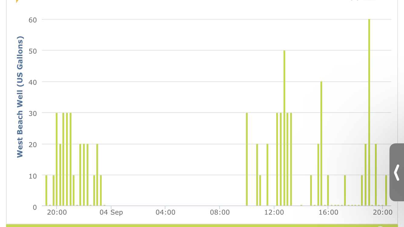

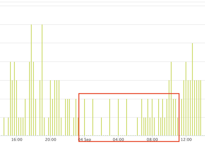

A further observation from last night: The summary data did eventually catch up, very shortly after I sent the above message. It looked fine. Curiously, later in the evening, I looked at the graph in the widget and that (approximately) 12-hour period had disappeared from the data, as had several short periods after.
It then reappeared sometime overnight (excerpted from a two-day query):
Screen Shot 2022-09-05 at 8.44.26 AM.png (61.94 KiB) Viewed 72289 times
Note that, in addition to the period in question, you can see in the images above that a random smattering of records after 12pm had also disappeared and then reappeared.
Grumble, grumble. :/

I can see your screenshot that shows a gaps in the data, then the second screenshot shows that the data got filled in. In the second screenshot, I only see the gaps being filled in, I dont see the data being altered, is that what you are also seeing?

As far as what I observed: The summary data was running about 12 hours behind. It then caught up. Some time later, those 12 hours worth of summary data disappeared again, as did a few random 15-minute summary results in the following hours. Very odd. And then a few hours later, it was all back again.
