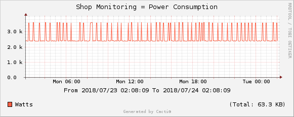

The annoyance I am experiencing is that the kWh reading are in 0.1 increments. This causes an amount of "spikiness" on the graphs, caused by the difference between the 5-minute polls from Cacti and the rate at which I'm moving energy. It works fine, but it looks ugly.
I would like to increase the resolution at which I read the data.

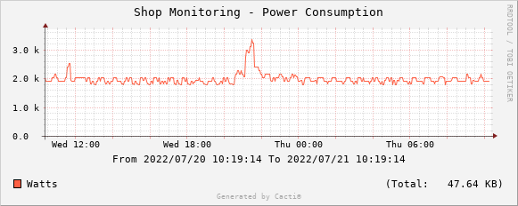

This is the new appearance of the graph. So much cleaner and easier to read! (Compare with the graph in the first post)
The 2kW "baseline" load is my building's summertime swamp cooler, the server closet and whatever other loads are always on. You clearly see the power consumption from when I worked in the shop last night, running the mill and with the high-bay lights on.
The next step will probably be to install the old v.3 meter on my server closet. I will use smaller CT's but leave the meter set to 200A to increase the effective resolution. I'll make the corrections in my polling scripts.
