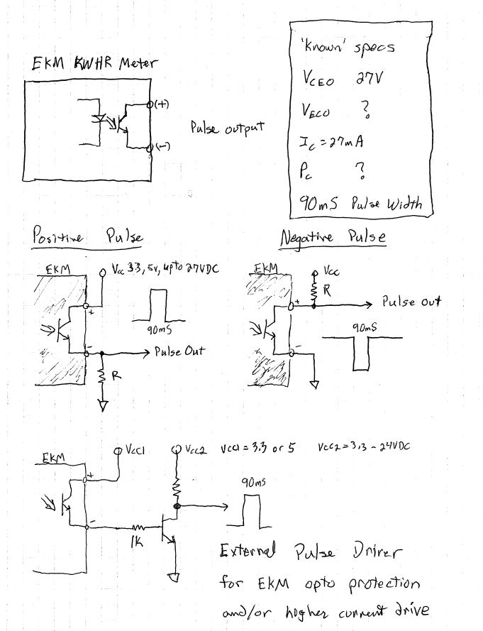

After doing some experiments, it seems that the 'solid state switch' is simply an opto-coupler with both the collector and emitter provided which is why the output has polarity. I provided a diagram of the EKM and two output configurations for Positive or Negative pulse outputs. The 27V spec would be the Maximum Voltage across the Collector-Emitter-Open (Vceo), and the 27mA would be the Max Current (Ic) of the opto-coupler. In general, you never want to approach these limits because if you damage the Opto output, you are done. Better to keep the voltages and currents low or provide an output buffer as shown below. Also note that long wires from the meter to your circuit are susceptible to induced voltage spikes so keep your circuit and close to the meter as possible and/or provide some type of transient surge protection.

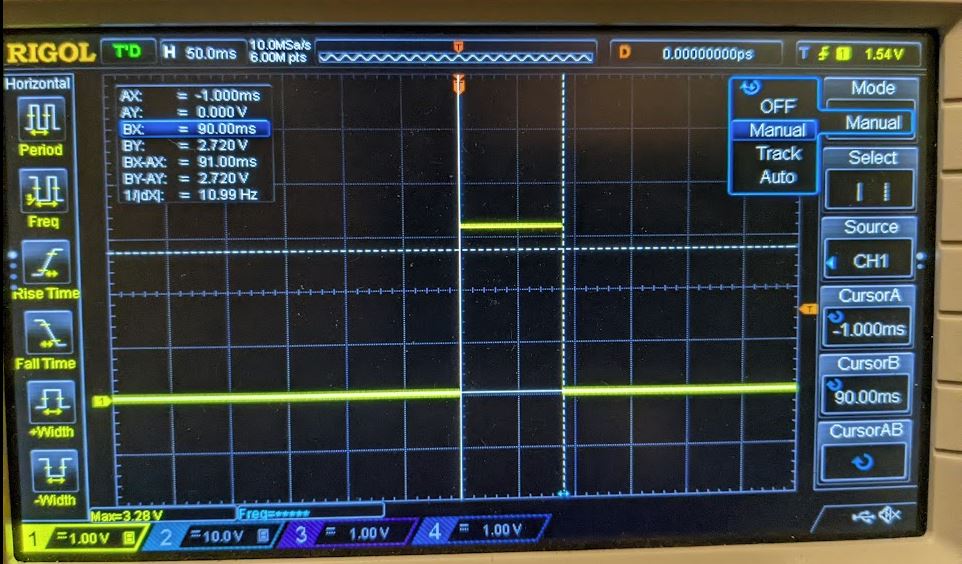

I have a Raspberry Pi Zero, so I decided to use that to read and count the pulses. After some trial-and-error, I came up with the following Python3 code that just prints out the same reading as displayed on the LCD each second. This is just proof-of-concept code to see if I could read the pulses and make it match the display. More work needs to be done to log the readings and read them remotely. I also provided an LED that is turned on by the code while the pulse is active and it flashes in sync with the Red LED on the meter. To start the Python Demo script you just open a terminal window and type :
