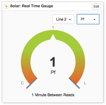

We tend to represent Power Factor as: 0 C to 1.00 (in the middle) to 0 L like this widget from encompass.io:
Screenshot 2015-08-21 11.55.31.png (20.76 KiB) Viewed 33156 times
Let me know if this fits with your understanding or if there is a better visual representation.

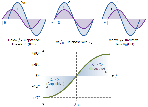

CIVIL: in a capacitive load (C) the current (amps or i) leads voltage (V), voltage (V) leads current (i) in an inductive load (L).
Mnemonics can be a PIA at times but in a sense yours and mine are identical and not at all opposite: Current Leads Voltage in a Capacitive Load.
Where the confusion sets in here is where it says: Voltage Leads Current in an Inductive Load when what it should be saying is Current Lags Voltage in a Inductive Load that there is no misunderstanding as which leads and which lags, essentially they can't both Lead just by changing the position of the Voltage.
Your original post was misleading for the fact that you stated that Inductive Loads were Leading and Capacitive Loads were Lagging when in fact they are they behave in the exact opposite. Inductive Loads LAG whilst Capacitive Loads LEAD.
With the Voltage reference point at 0 (zero) current either Leads or Lags Voltage. The only quantity that Leads or Lags is Current and it Leads and Lags in reference to Voltage.
This is best represented by the following diagram:
ELI the ICE man.gif (18.82 KiB) Viewed 33152 times
Screenshot 2015-08-21 11.55.31.png (20.76 KiB) Viewed 33152 times
I see nothing wrong with this! I think it's a reasonably fair representation of what is occurring in a circuit.
If we were to represent L on the right hand side as Inductive Loads then that would be represented with a +ve symbol which is what what an Inductive Load is considered and C on the left hand side being the Capacitive Load would be -ve symbol.

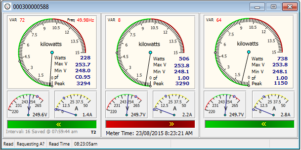

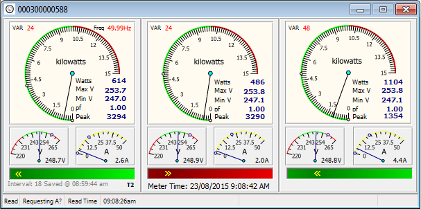

Here are some examples that I captured from a V 4 meter:
Single Phase 240Vac 50Hz Co-Generation System using a Solid State Transformerless Inverter:
L1 - The meter on the left hand side is Net metering the Import & Export of the Co-Generation System
Green = Exporting, Red = Importing, Black = Inverter Power Only is being used
L2 - The meter in the middle is metering the Total Consumed Power Only (Either Imported or Generated Power or a combination of both)
L3 - The meter on the right is purely metering Generated Power
The vars is in the top left hand corner of each meter
VAR 1.png (26.49 KiB) Viewed 33137 times

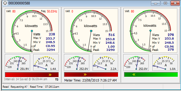

Green = Exporting, Red = Importing, Black = Inverter Power is being consumed by the Load - No Importing or Exporting is taking place.
L2 - The meter in the middle is metering the Total Consumed Power Only (Either Imported or Generated Power or a combination of both) Always Red when Load is consuming power
L3 - The meter on the right is purely metering Generated Power (Green = Generation whilst Black = NO Generation)
Call this as "vars" Received - The inverter is in a capacitive state and the load cannot absorb the reactive power so it is sent to the Grid even though we importing power at the time.

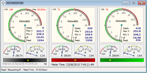

The inverter and the load are in a capacitive state and the combined reactive power from both is sent to the grid or is it?
There is no importing or exporting here, the load is consuming 100% of the generated power.
VAR 3.png (30.95 KiB) Viewed 33137 times

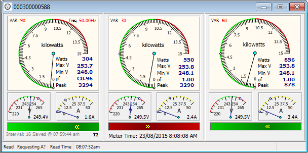

The inverter and the load are in a slightly capacitive state and the combined vars are sent to the grid with the power being exported
VAR 7.png (31.11 KiB) Viewed 33137 times

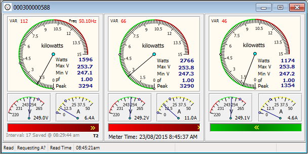

Here the inverter is in a slightly capacitive state while the load must be in a slightly inductive state.
The inverter line (L3) is showing 48 var of which 24 are being absorbed by the load and the other 24 are being sent to or received by the grid.
VAR 12.png (31.52 KiB) Viewed 33137 times

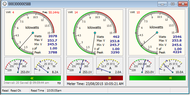

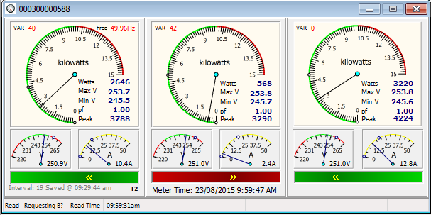

Here the inverter (L3) shows 0 vars (theoretically "in phase") yet the load (L2) shows 42 var and the Net meter (L1) shows 40, allowing for a small anomoly of 2 vars and the fact that all the PF are showing 1.00 or Unity you cant tell if the Load (L2) vars are inductive or capacitive, but most likely to be inductive in this case.
VAR 13.png (32 KiB) Viewed 33137 times
Can you see what is happening here?
VAR 14.png (31.94 KiB) Viewed 33137 times
And can you see what is happening here?
VAR 15.png (31.65 KiB) Viewed 33137 times

Jameson: My original question remains:
Restating: If the v4 meter does not report "capacitive" or "inductive" VAR then there is no way to do the correct VAR calculations in the two meter scenario; V4 meter on service entrance, V4 meter on inverter, with net consumption left to calculation. As explained by BlueHornet:
"all the PF are showing 1.00 or Unity you cant tell if the Load (L2) vars are inductive or capacitive, but most likely to be inductive in this case."
It is the "most likely" above that I consider an issue; guesswork instead of reported data. Rather than being simply a pedantic point of contention having correct VAR data available is valuable; for example analyzing VAR can yield information on the number (of operating) and load state of motor driven equipment such well pumps, refrigeration (heat pump) etc.
Such calculations are enabled for "real" power by virtue of the (real power) "current direction" indicator. The distinction between inductive and capacitive VAR can be viewed exactly analogously to real power forward/reverse, with the indicator being the "C" or "L" part of PF.
If the C/L is not blanked out at indicated "1.00" that will solve the problem. I say "indicated" because clearly power factor is being rounded off due to output reporting precision limits, not due to fundamental internal data precision limits.
A simple firmware change ought to take care of this.
Any chance?
Re: v4 meter VAR phase - missing for high PF?
Thanks jcb,
Yes, I think I see what you are saying. Now if the meter reports 1.00 Power Factor, and 2 VARs on Line 1, you cannot tell if these 2 VARS are inductive or capacitive, you have to make a best guess at this point. Is this true?
But if the power factor is 0.99 then you will know if the VARs are inductive or capacitive. Correct?
