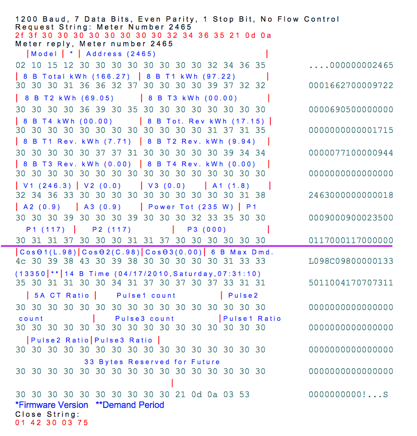

From what I am seeing it looks like you are only sending me a partial Hex response. It very well could be the Dash is only reporting a partial read in the Hex inspector. See the attached screenshot, it is like what you are telling me is just the portion under the purple line. (Dash is not well tested on v.2 meters)
Screenshot 2016-12-08 10.11.59.png (165.52 KiB) Viewed 24955 times
What is your ratio of good reads to bad reads?
