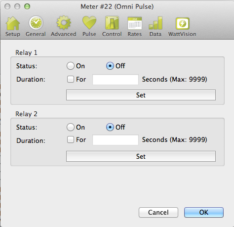

Yes, you can control the 2 relays via the EKM Dash. At this point you can control Output1 or Output2 (these provide 50mA of 12VDC each) ON, OFF, ON for 1 to 9999 seconds, or OFF for 1 to 9999 seconds.
To control relays via the EKM Dash, go to Edit Meter > Control Tab (see screenshot). The default password for your meter is "0" (I would not change the password unless you have a very compelling reason to do so). See this screenshot for Omnimeter Pulse v.4 #22
Screenshot 2014-02-15 12.23.26.png (64.92 KiB) Viewed 65885 times
