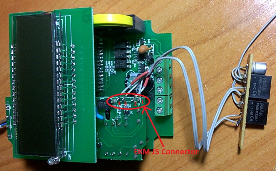

Here is what I got from our engineering group, as suggestion.
Not sure how it is accurate, they just spend a day to look into this.
Pic. 1 External Power Supply schematic
To power the EKM, when there is no input voltage across all three phases, it is proposed to add an additional circuit to the EKM for external backup power. Please see Pic 1. As a backup power source, any 12 volt uninterruptible power supply (for example from alarm systems) is used. Schematic contains two isolated dc / dc converters DC1 and DC2 that provide isolated 12 volt power for the operation of the EKM main board and RS485 communication interface.
Pic. 2 J5 EKM connection
Connecting of the circuit to the EKM to the J5 connector shown on the Pic. 2.
V. Rublyov
Re: DC Power Supply to EKM Omnimeter Pulse v.4
Riv,
Thank you for posting! How is the modified meter working for you? Have you tested other functionalities (metering, communications, pulse counting etc)? We have done similar tests in the past, but always come up with issues in the way the meter functions (pulse counting not working reliably for example).
