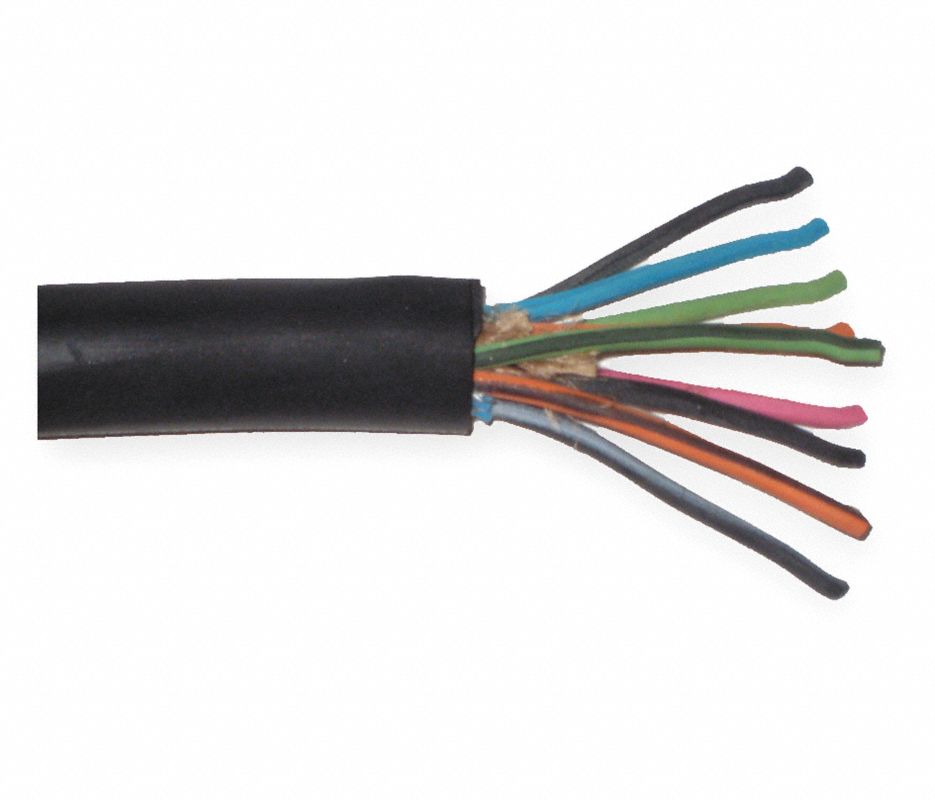

- Original CT wires are twisted. Will it give any bad impact if new extended wires will be just straight, combined into single outer jacket with other CTs and voltage wires together? Something like Carol Super 18 AWG 6-7-10 Conductor SOOW cable.
No I do not believe the CT wires have to be twisted to remain accurate. Only the RS485 data wire needs to be twisted. The twisting of the wire keeps the RS485 signal clear.
