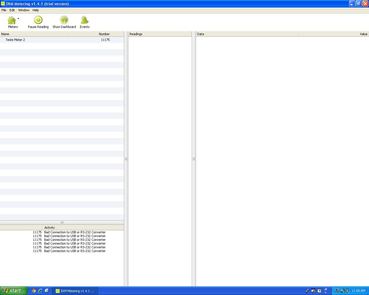

I download the EKM Dash trial to test the readings, but I couldn't get the communication working
It keeps saying that I have a "Bad Connection" or "No Response"
I attached the pictures of the errors and how I connected the wires on meter.
Any ideas why is it not working?
Thanks!

Re: RS485 Bad Connection
Hello kennycaldas,
Thanks for posting your question to our forum.
The message you are getting in the EKM Dash indicates that the Dash (your PC) is not able to connect to your third party USB converter. The Dash is converter model agnostic, but because it is not one of ours I would not be able to say why your USB converter is working or not. Please make sure you have your EKM Dash pointed to the correct port (on a PC this could be COM1 to COM24 or more). To check this on a windows PC I believe it is under Control Panel > System > Hardware > Device Manager > COM Ports
So the issue is not the connection from the USB converter to the meter, it is the connection from your PC to the USB converter.
And as a heads up, third party USB converters tend to give us a lot of headaches surrounding the communications from the USB converter to the meter as well. We use terminating resistor values and biasing resistor values in our USB converters that give them optimal communications with our products.
