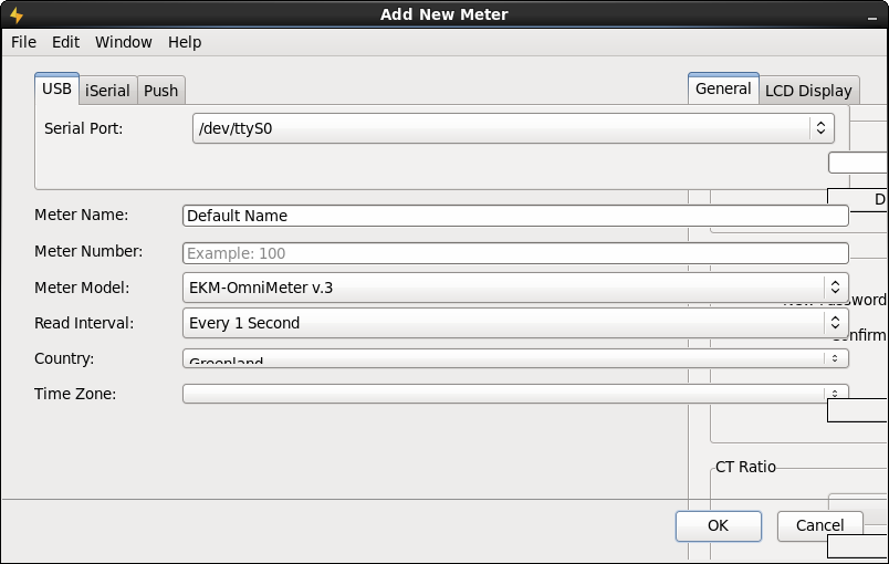

I managed to get dash (1.8.2) to start on centos 6.6, 64 bit, but I do not think it is working properly, some highlights:
Some console messages are spewing:
gtk unhappiness, not located theme clearlooks, not loading canberra
Add meter dialog:
1) GUI is not properly displayed; items are cut off and not fitting in window
2) Click on iserial tab is non-responsive (I have iserial and need this to work)
You probably already know there were a few libraries that needed to be installed, some xojo forum digging required to identify.
Any ideas on getting this thing working for me?
thnks

I took screenshot of the bum dialog, I will try to upload in separate post

dunno how much help it is, but attached the screenshot
- snapshot_bad_dialog.png (37.87 KiB) Viewed 20914 times
Re: dash issues on centos 6.6
Hmmmmm, that is a mess! Any other screenshots that you can send that show how the Dash is improperly displayed will be helpful.
