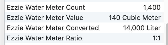

Here is what it spits out in the data stream:
Screenshot 2019-12-30 21.48.50.png (31.32 KiB) Viewed 51081 times

Thanks Jameson. Works like a charm!! I didn't realize you could set the Pulse Value to a decimal - wow, slick product. You guys are amazing and have an incredible product line.
