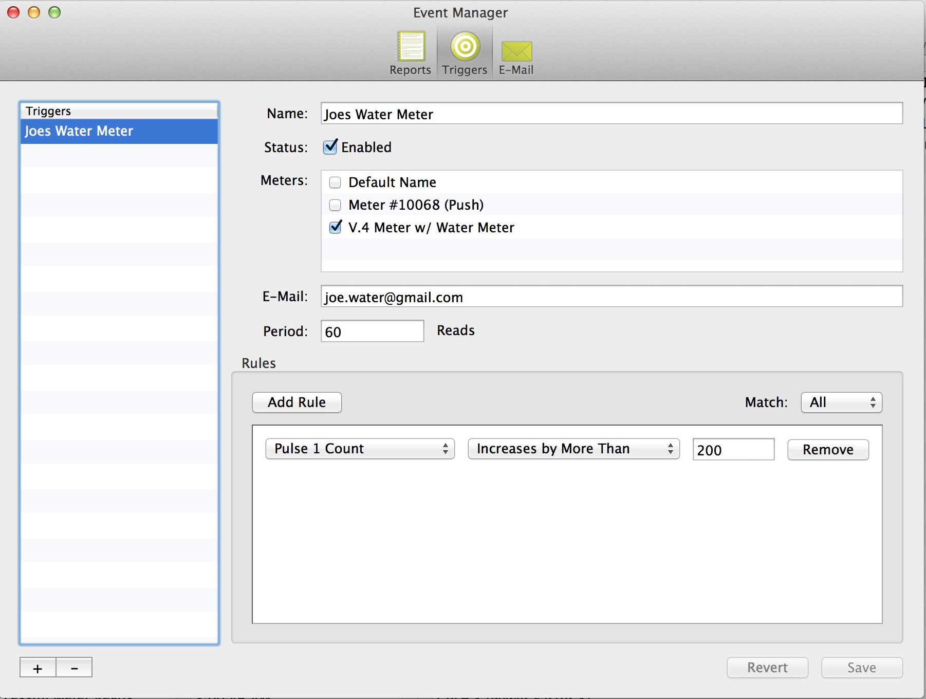

Re: Request for new feature: alarm when wateruseage is high
Hi jliakos,
We are pretty happy with how the triggers functions works. For a water meter I would set it up in some way similar to the attached. Just play with the number of pulse count increments per number of meter reads (this defines the time period).
Go to Events > Triggers
In the attached example, the Dash would send an email if it saw over 200 pulse increments within 60 reads (1 hour for a 1 per minute meter). The Dash does have to be running in order for this to work.
Hope this is what you are looking for.
