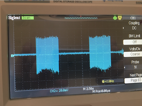

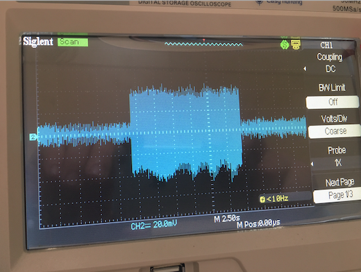

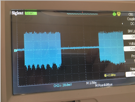

Hello Mike,
Very interesting. Thanks for the audio clip. I have not heard of this before to be honest. It seems like more than normal signal bounce due to the reed switch, though I cant imagine why your meter would be any different. All it is inside our water meter is a magnet on one of the dials. The magnet pushes a reed switch closed for every rotation. I cant imagine why the magnet would push the reed switch closed twice for every rotation.
I tried to reproduce what you are seeing on a random water meter here, but I could not reproduce the signal gap using an oscilloscope. The pulses you see in the attached images are a few seconds wide.
All I can suggest is to swap your water meter for a different one, maybe your reed switch is too far from the magnet and gets some weird affect when it passes through the outskirts of the magnetic field.
