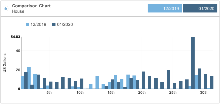

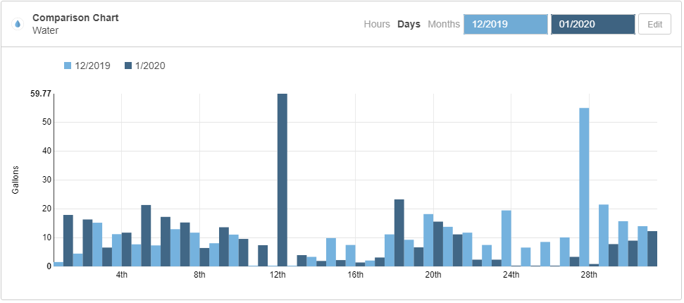

I'm seeing a different issue between the Comparison Chart widget and the report. On the widget, the graphs appear to match the data, but the report shows a very different set of charts. See below.
This chart is from a report that covers 12/1/19-12/31/19 vs 1/1/20-1/31/20.
Here is the widget that covers the same time period for the same meter.
It looks kinda similar for January, but December isn't even close. Maybe the first day of December is different because of the timezone, but I think there's a lot more going on, which should be obvious based on the other differences. The report colors also don't match the legend, but the widget appears to be correct.
My experience has been that the widgets are typically more correct than the reports. The data I get from reports is untrustworthy and I am starting to not use that feature as a result. Not being able to pick a timezone has caused some issues as well with my tenants since they have access to the physical meters and they've accused me of making rounding errors in my favor. Once I went through the hassle downloading the data directly and showing it to them, they calmed down, but it's still a problem that could have been avoided.
The reports also take a long time to send. One of my tenants needs the report on the first day of the month, but the automatically generated report doesn't show up until the second day of the month, so I have to manually generate it. There's no setting for the day the report is generated.

Hello bandtank,
Thank you very much for bringing this to our attention. We would like to see the full pdf report that you are comparing the dash widget to. It does look like something strange is going on. Would you be willing to email us the full pdf report so that we can check it out? Please email it to support@ekmmetering.com
Sorry that you are seeing this issue, hopefully we can get it sorted in encompass.io very soon.
Yeah it can take quite a while for the encompass back end to generate all of the necessary pdf reports and email them out to all customers. You are right that this is not ideal, but there are just so many (particularly at the first of the month) that it creates quite a backlog. We are always working to improve encompass, reports and billing have been our main focuses of late. Please keep checking in to see if the improvements are working for you.

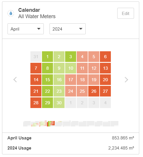

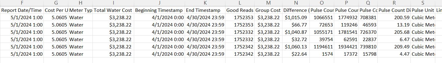

I am seeing something very strange with the widget numbers as well. I have six water meters on a system, the data downloaded for the month of April and displayed on the info widget showed 639.89m³, but the April Calendar widget showed 853.865m³. Looking back, I noticed that February (the installation month) and March were also inflated by ~25%. To make this more confusing, the monthly report showed the 639.89m³ reading, but an upstream water meter that feeds all six, only showed 601m³ for April. What could the calendar widget be looking at to come up with such an inflated number?

Re: Report vs. Widget Discrepancies
Thank you, at first blush I think this may have something to do with daylight savings time, but Im not sure. What is the EKM-Omnimeter number and Pulse Input number you are looking at?

Post by INTELLECTRIC »
Sorry for the delay getting back to you on this. The meters are 000300013982, 000300013987, and 000300014018. I don't have the Omnimeter number just at the moment.
Hi, thank you very much for letting us know. We actually saw this same issue last week, so have been working on a fix. Will you take a look at your calendar widget again? We think we have it fixed.
