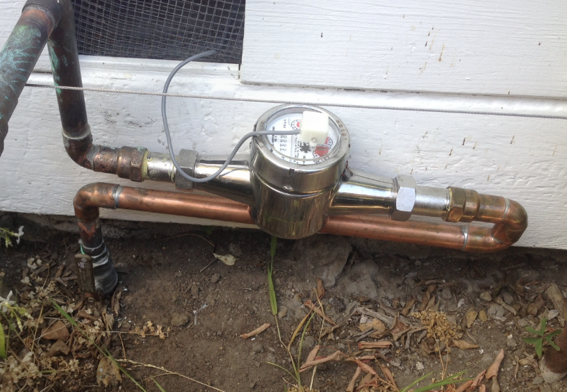

Here is an example of an older style horizontal water meter installed in a vertical situation, minus the recommended straight pipes before and after the water meter:

Thanks Jameson. I think your solution is the way to go. I'm definitely concerned about accuracy, so I want to get the piping right. I'm also looking into meter horns / meter setters, but getting a pipe made similar to your picture seems like the way to go!
