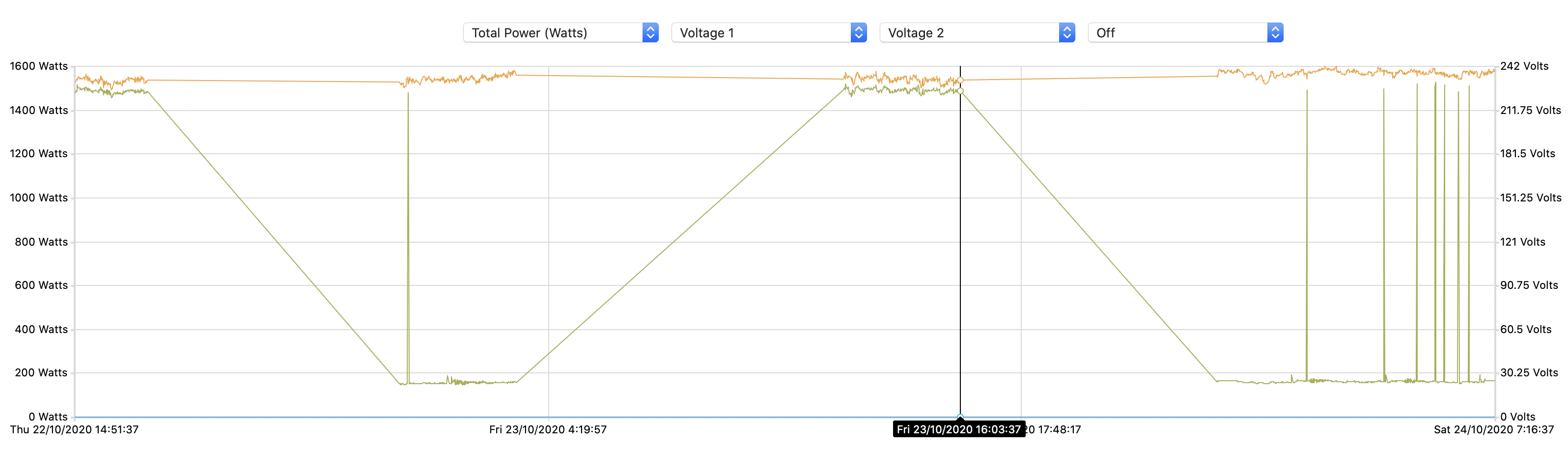

- Screenshot 2020-10-24 at 1.19.20 PM.png (683.88 KiB) Viewed 73360 times
Re: EKM Dash 2.2.4 performing poorly on MacOS Catalina
Hello Piet,
Great to hear from you. Sorry that you are having trouble with the stability of Dash 2.2.4 with Catalina (OSX Catalina has certainly been its own ball of wax!) Yes, please post the error reports here or email them to support@ekmmetering.com
I have also experienced similar things and have not yet narrowed down as to why it happens (so any insights any of you have out there, please let us know). But if I run the EKM Dash for something like a week at a time on a Mac, it sometimes will go unresponsive. I have to "Force Quit" Dash in order to get it back. I have not noticed the "skipping 200 or so reads" that you mentioned. Is this when your mac is asleep, or does it also happen when you are using your mac and it is not asleep?
The more evidence we can gather as to when this happens, or why this happens, the easier it will be for us to fix it. Thank you for your help, we really do appreciate it

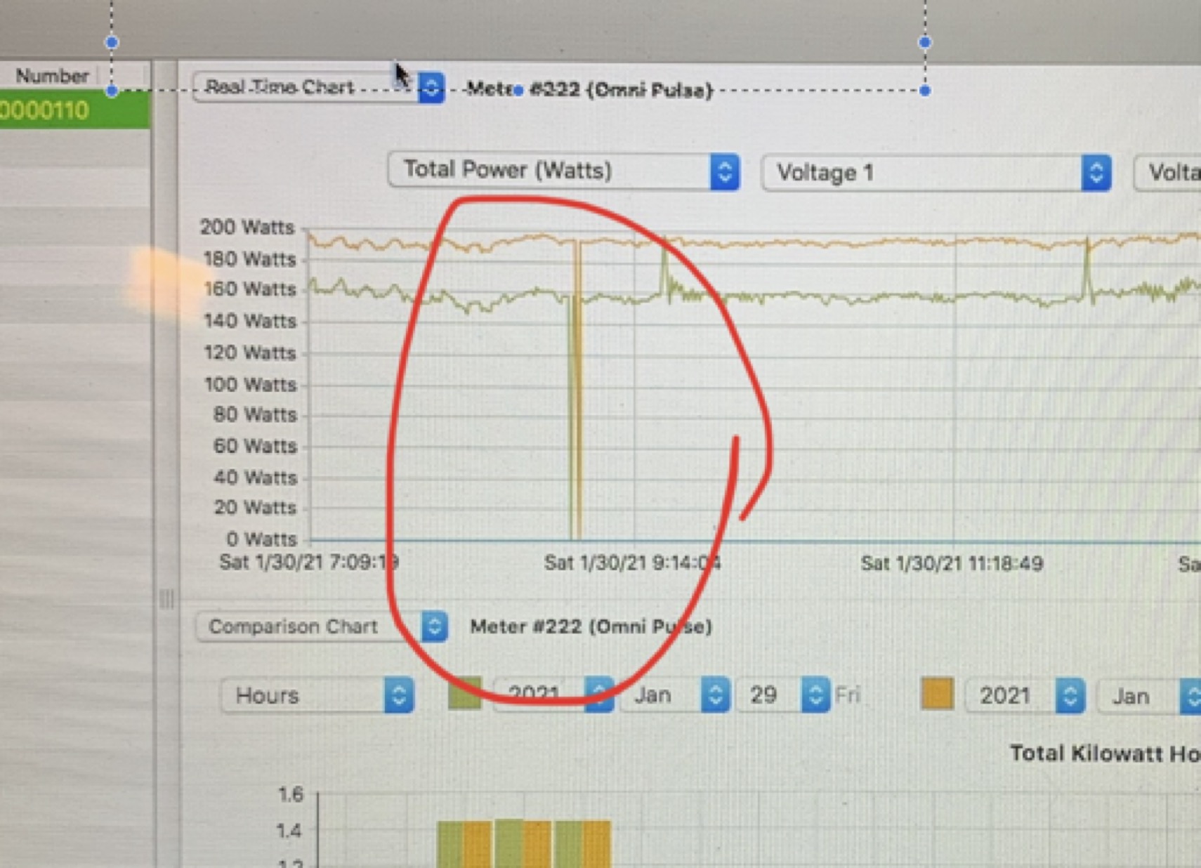

- Screenshot 2021-01-30 at 10.47.18 PM.jpg (307.09 KiB) Viewed 70006 times
Interesting. I have not seen this before. Are you saying that you get this drop out consistently once per day? Is it always at the same time of day?
How are you reading this meter? Is it via a USB converter or the EKM Push system? Does both Total Watts and Voltage drop to zero? Is it just for 1 read? In your screenshot it looks like the green line and the orange line drop at different times. That is very odd.
You can avoid the triggers going off by making your triggers fire only if they see > 1 reads in a row with the trigger value.

-The dropout is not consistent and roughly about 1 x per day to as low as 1x per two days. Sometimes there are 2 dropouts on the same day for different measurements (such as in the example photo).
- Occurs at seemingly totally random time.
- I am reading from the Dash push system via www.
- The title of this blog "EKM Dash 2.2.4 performing poorly on MacOS Catalina" is actually no longer applicable here: to get away from Catalina I have switched to an old machine which runs macOS High Sierra.
- Indeed it is just one read that has some zeros where on the next read things are back to normal."Some zero's" mean that more than one measurement can be 0 at the same time. I cannot see any pattern.

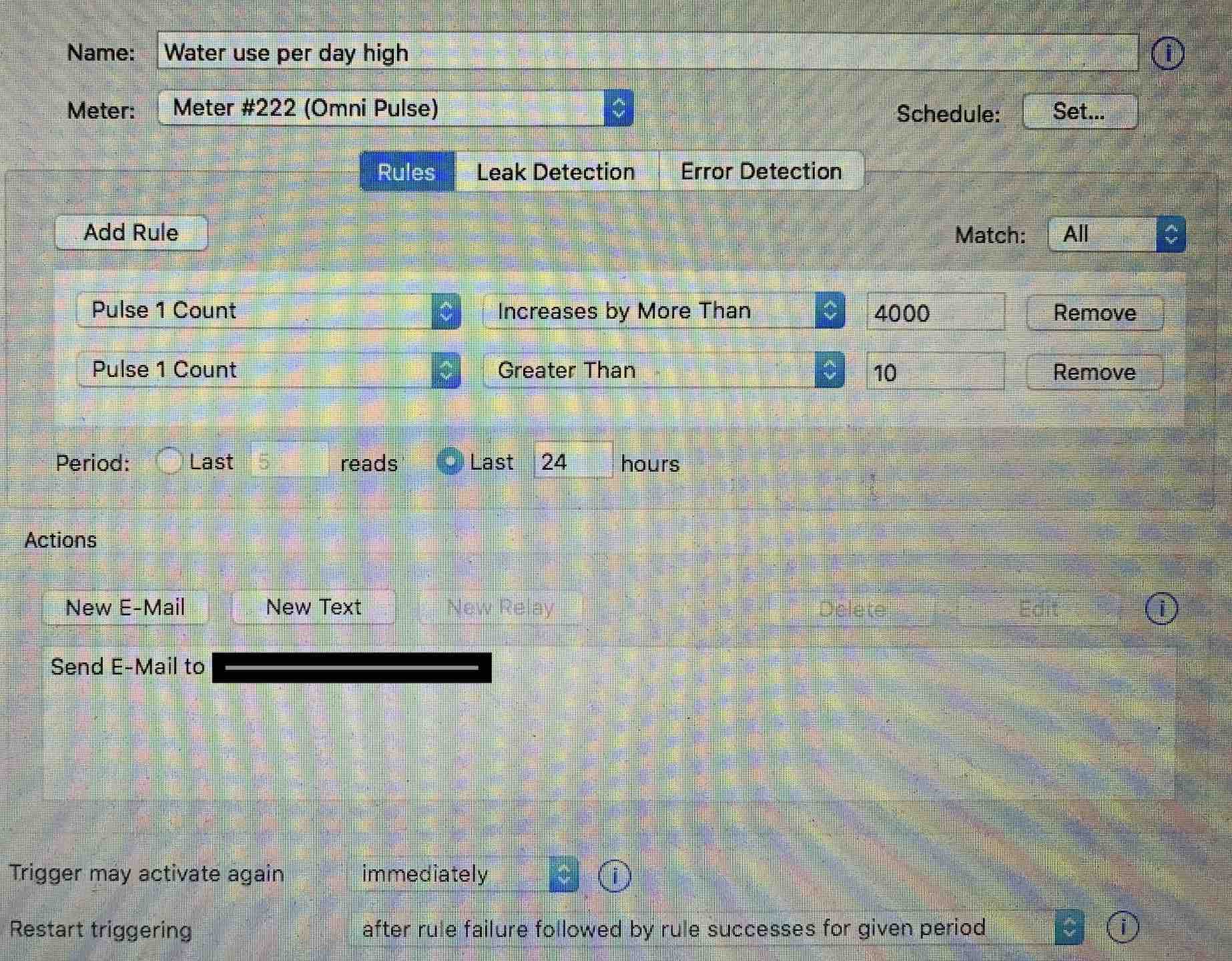

On the suggested solution: I am not sure how this is meant to be implemented. For example I have this trigger for the garden watering system (which is supposed to be off for like 10 months):
Rule: pulse count 2 increases by more than 1. Period = last 24 hours (trigger activate again after one hour, restart trigger after rule failure followed by successes for a given period)
So after one spurious "0" read the increase is a large number, way larger than 1 (back to the original count i.e. thousands). I don't see a way around this. Otherwise this method works well (and used to work well in the past).

Will you send me a screenshot of your trigger setup in your Dash software? Are you triggering based on pulse counts? Or on watts? Your screenshot that you sent with the dropout was a graph of watts.

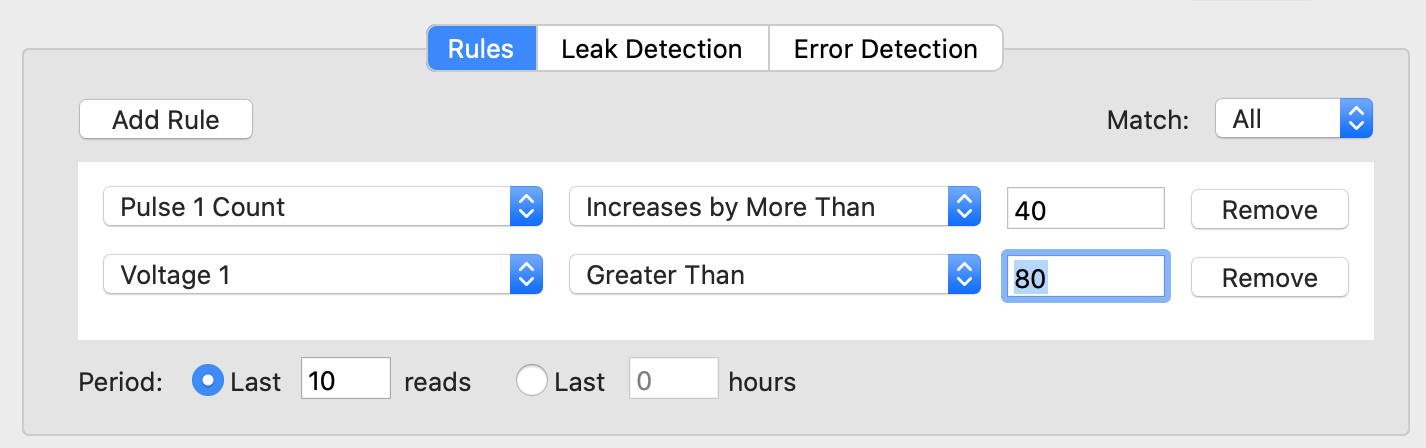

It sounds like pulse counts, so maybe you can add something like volts, because when you have a dropout, I assume all data (such as volts goes to zero as well, but Im not sure without looking at your data). So I would try something like this:
So in this case the voltage would have to be above 80 volts AND the pulse count would have to increase by more than 40 within a span of 10 meter reads for the trigger to fire. How does this idea sound?

- Sreenshot of trigger set-up
