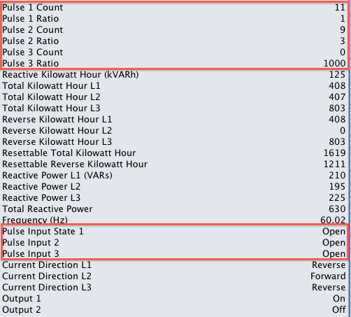

I will attach a screenshot of some Omnimeter Pulse v.4 data from the EKM Dash. It shows the 3 separate Pulse Ratios and Pulse Counts highlighted in the Red box at the top and the 3 separate real-time input states highlighted in the Red box below. If you have a pulse ratio set to 1000 to 1, it takes 1000 pulse outputs from your pulse output water or gas meter to register 1 on the Omnimeter Pulse v.4.Pulse Input:
Fig. 6
The Omnimeter Pulse v.4 can also count the pulses from up to 3 different pulse output devices. These could be pulses from our Pulse Output Water Meters and Pulse Output Gas Meters or from any other unpowered dry contact pulse output device. Pulse Input ratios can be set in software from 1 to 9999 pulses per increment. The state of the 3 Inputs can also be polled in software. The Omnimeter Pulse v.4 will return a High or Low state for each pin in real-time (use this for sensing switch states, open or closed doors, etc). Connect Pulse Generator or Switching Sensor to each of the 3 Pulse Inputs. Connect all grounds to port 14 and each of up to 3 Pulse Output Devices to ports 11, 12, or 13.
