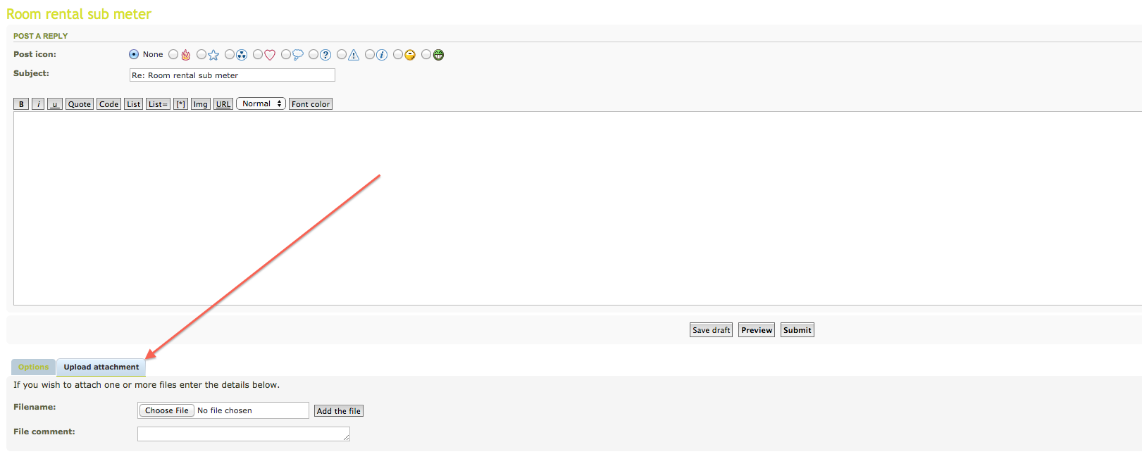

I appreciate all the help. I'm sorry but how do I attach a pic?
Re: Room rental sub meter
You can either email it to us, or look at the attached screenshot.
Screenshot 2014-06-19 18.52.30.png (82.34 KiB) Viewed 18539 times
