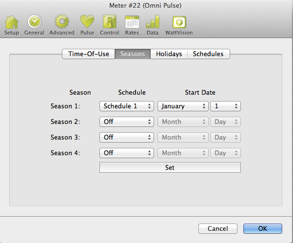

So, the first thing to check, and this may be the entire issue (we did not realize it because in our testing we always had this enabled), is that you have a Season selected (without this the meter weekend/holiday TOU does not work properly). If you dont have a season selected I would just put in January 1st. I think we will fix this by forcing a season when you have weekend TOU enabled in the EKM Dash.
Here is a screenshot showing January 1st enabled in the "Seasons"
Screenshot 2014-11-17 10.04.18.png (76.02 KiB) Viewed 49830 times
Let us know if you already had the seasons enabled. Thanks!

Yes the "Season" was set as per your screenshot, the weekend rates were set, all the TOU settings were displaying correctly as they were set (TOU, Seasons, Holidays & Schedules) but the energy was accumulating to the T2 register at a time when it should have been accumulating to the T1 register, like I pointed out in my earlier post the TOU had worked flawlessly since the firmware update up to this point.
The anomaly where TOU changed from the T1 bucket to the T2 bucket in the middle of the afternoon only occurred after the power failure I described whilst there was solar generation.
