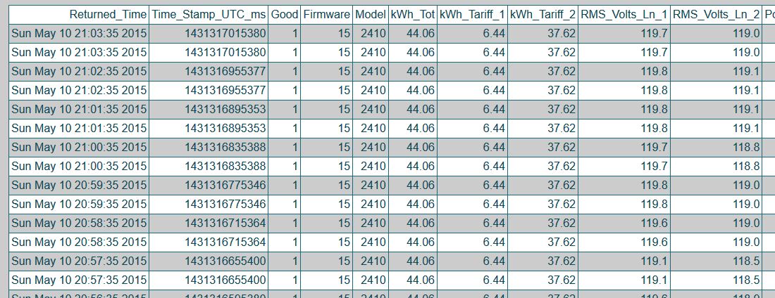

One more question... although the API call supports filters by date, it appears only the most recent 1024 data points are available. With 1 min sampling, that is about 17 hours. If data older than that is necessary, it looks like it must be saved at that time or it is lost.
Also, when I'm reading the push data right now, I get double entries, both of which count against the 1000 read limit, effectively reducing the readable data to just the past 8.5 hours.
Anyone else run into this?

Re: EKM Push
Post by BlueHornet »
I think your right in your assumption that its only the last 1000 entries at 1 minute sampling that is available (unless you have organised a different sample rate with EKM)

sensij
Posts: 7
Joined: Fri May 08, 2015 9:48 am
Re: EKM Push
Post by sensij »
Rebooting the Push (or the meter) resolved the double posts. I'll post on this topic again if it happens in the future.
