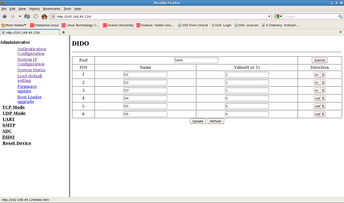

I have some doubts on the DIDO settings of the iSerial device. Please find a screen shot of the same. Please let me know if these setting are correct?

I have confirmed the IP address. Additionally, I'm testing it on a second network setup without any port blocking. I am also able to reach the iSerial configuration menu using the same IP. When the Dash software polls the meters, the link light is flashing which tells me that traffic is flowing between the PC and the iSerial device. From the Dash software, I can see that the iSerial device polls the meter and returns a "(Meter Number) Read Regular Data Error" as per the screen shot above. Kindly confirm that the DIDO settings are correct.

I have never gotten the DIDO settings to work and as far as I know they do not work and do not do anything, so I would just leave them as they were. They are not necessary for reading your meters.
