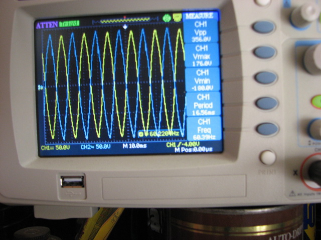

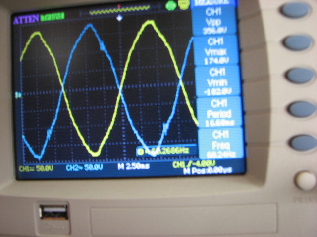

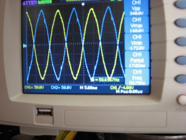

BTW gen power look clean. Screen shots if I can figure a way to post them

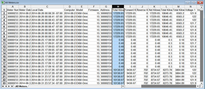

Look at line 8 then 19. on previous included Dash Data.
Dash quits reading V4-233 Then starts again but it has moved 702 KWH from Total KWH to Rev KWH
