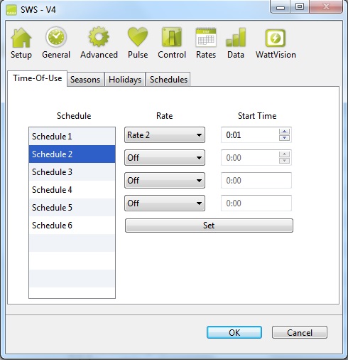

In an attempt to be clear about the Schedules & Weekend Schedule and TOU registers behavior I am experiencing.

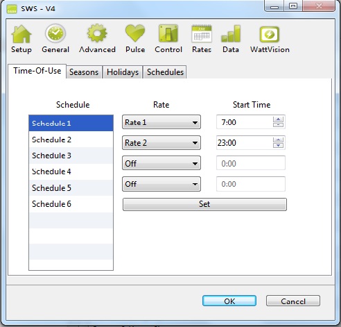

DASH can certainly set the Schedule times and the weekend schedule in the meter, proof of this is that if you shut down DASH and restart it, navigate to the rates tab it will retrieve what is stored in the meter, which correlates to the schedules and rates settings that I have previously entered - No Apparent Issue.
If I set only a 2 Tariff (Rate 1 & Rate 2) Schedule in say Schedule 1 - Peak & Off Peak say Rate 1 (TOU1) - Peak Start 07:00 & Rate 2 (TOU2) - Off Peak Start 23:00 there is no apparent issue, it will run for 7 days a week and allocate the kWh consumed or generated to the correct TOU Registers TOU1 for Peak & TOU2 for Off Peak, this is also evident at the meter where the T1, T2, T3 & T4 symbols display correctly at the appropriate times as per the Schedule and the values I see for the T1 & T2 registers are consistent with what I would expect to see.
However!
If I then create a Schedule 2 (Off Peak) to Start at 00:01 (12:01am) as Rate 2 (TOU2) and apply the Weekend Schedule to use Schedule 2 the settings are most certainly being applied to the meter Weekend Period Table but any kWh consumption or generation are accumulated to the same registers and times as set in Schedule 1 and not as it should, which is to accumulate the kWh consumed and generated during the weekend period as per Schedule 2 time and to the Rate 2 - TOU T2 register.
Now I hope there will be a speedy resolution to this issue as to date there seems to be several untested or stagnant branches to the metering solution. DASH whilst appearing complete does not handle TOU correctly nor does it offer a complete monitoring solution, PUSH for V4 users has been touted since the V4 was first marketed and encompass.io has no value for V4 adopters till PUSH is made functional for V4.

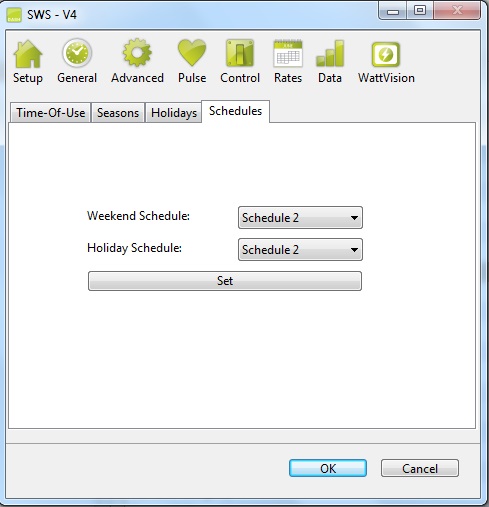

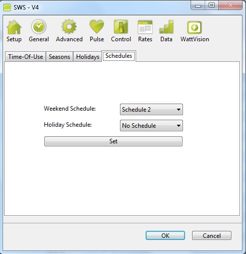

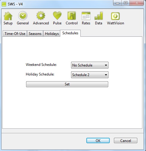

Not sure what these are going to tell you that I haven't already described but here are the screen shots you requested, and just as a matter of interest I tried the Holidays Schedules and they too do not override the Schedule 1 settings and the meter continues to accumulate TOU registers according to the Schedule 1 time settings when they should be overridden and accumulating to TOU2 register.
Both the Holiday and weekend schedules do not behave the way they are intended to.

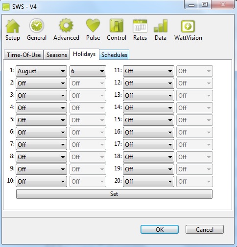

And here are the Holiday Schedule Screen Shots

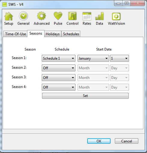

I may have solved my own issue regarding my TOU registers not activating correctly as per the allocated weekday and weekend schedules, I will conduct further testing to establish that this is 100% correct but in the meantime this what I have determined.
Irrespective of whether your tariffs/schedules work on a season basis or not, you need to set at least a "season" start date for Schedule 1- this may actually work with/for any Schedule!
So far this has worked for Weekend TOU 2 and Holiday TOU 3 that I have set up and simply advanced the meter time to the appropriate weekend or holiday date and time that needs to be overridden by the Schedules 2 or 3.
Now if this proves 100% correct and I have no doubt that it will, the software needs to be amended so that if a weekend or holiday Schedule is selected you will also need to set a Season Schedule irrespective of whether your Tariffs/Rates use them or not. Alternatively a default Season for Schedule 1 could be set into DASH starting January 1st. Obviously there are other methods in ensuring that the Weekend & Holidays Settings are tied in with the Season Settings.
