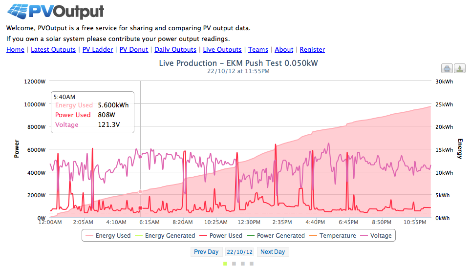

I wanted to let you folks know how awesome this is. We absolutely encourage others to utilize the meters or EKM Push data for this exact type of application. A perfect addition.
I have been playing with sending EKM Push data to PVOutput.org for the last few days. It works great! It is really set and forget, it just works.
Here is a link to our feed: http://www.pvoutput.org/intraday.jsp?id ... t=20121022
This is using demo EKM Omnimeter #: 10068 with demo EKM Push User Key: MTAxMDoyMDIw
The best part about this is, you do not have to have a computer running for this to work. The EKM Push gateway is reading your meters and sending them to the EKM Push database. PVOutput is automatically accessing your data (using your EKM meter number and EKM Push User Key) and then graphing and storing these reads. You can then fire up your computer at anytime from anywhere in the world to see all of your meter data.
Screenshot from PVOutput.org (this is for energy consumption only, we will set up a solar generation feed soon):
EKM Push Data to PVOutput.org
Screen shot 2012-10-22 at 11.33.00 AM.png (117.59 KiB) Viewed 36473 times

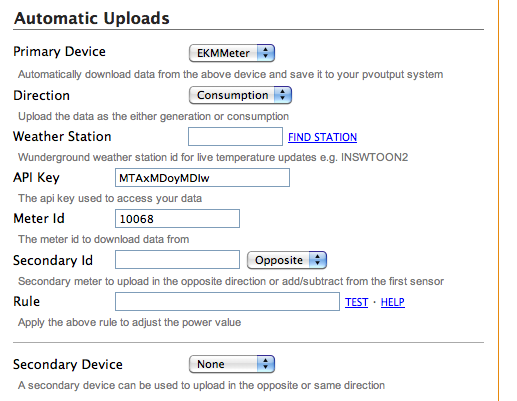

Screenshot of Settings needed to setup your EKM Push account:
EKM Push Settings in PVOutput.org
Screen shot 2012-10-22 at 11.42.41 AM.png (52.34 KiB) Viewed 36473 times
Instructions for setting up PVOutput to pull data directly from your EKM Push account:
  • Create and account at PVOutput.com
    Create a New Output
    Edit your Output (this is next to your system name under "Edit")
    Go to "Automatic Uploads"
    Select Primary Device: EKMMeter
    Select Production or Consumption
    Put your "EKM Push User Key" in the API Key field
    Enter your EKM Meter Number that is connected to your EKM Push
    Wait about 20 minutes (if it is setup wrong it will say "This system has no live data on **such and such date**"
    Takes just a few minutes.
