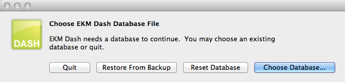

On the original computer, hold the "Shift" Key as you are opening the EKM Dash. You will see this window:
Screen Shot 2013-08-15 at 10.51.42 AM.png (32.67 KiB) Viewed 12778 times
Select "Reset Database"
Click OK

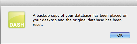

Screen Shot 2013-08-15 at 10.52.46 AM.png (21.83 KiB) Viewed 12778 times
Transfer the Backup file to your new computer.
On the new computer, hold the "Shift" Key as you are opening the EKM Dash.
Select "Restore from Backup"
