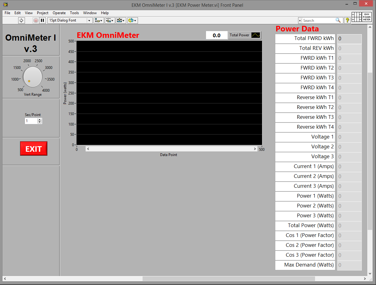

Hi All,
I have developed vis to read data directly from the Omnimeter I. Perhaps it also works with other models.
I took on the project because the OmniMeter is part of a system to get electricity from a modified diesel engine that runs on syngas (Hydrogen and Carbon monoxide). The system automation involves collection engine parameters and power output to optimize the amount of syngas going into the engine and add diesel if necessary. It also collects data from several other sensors to automate the entire system from biomass input, gasification control, char output and engine control. It is a complex automation program I did in LabVIEW thus the need to get and process the OmniMeter data in real time.
Here is a screen shot:
The software is located here: http://documents.ekmmetering.com/LabVIE ... eter_I.zip
The vis were created using LabVIEW 2011
Perhaps someone else can find this useful.
Alejandro Andreatta

Alejandro,
thanks a LOT for developing this VI and sharing it with us. I too have an experimental setup that requires simultaneous DAq from several instrument, the OmniMeter being one. I was breaking my head trying to figure out how to read the data via LabVIEW and your VI came to the rescue!
Anyways, I tried running the VI, albeit I had to save it to a previous version (2009) as that's what we have in the lab. The code runs without error but doesn't output any data. It even writes the data files with the headers, but that's that, no actual numbers. Any clue as to what might be going on? Do I have to specify the meter number in LabVIEW for the code to be able to recognize the meter and read data?
Would really, really appreciate any inputs/suggestions you can provide.
Again, thanks a bunch for sharing this!
Jignesh
