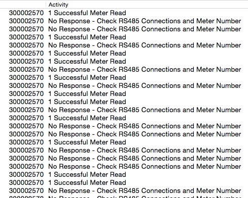

I seem to be getting about 40% successful meter reads; that is, 60% of the time I get
"300002570 No Response - Check RS485 Connections and Meter Number" and 40% I get
"300002570 1 Successful Meter Read".
I have ohmed the connections from the meter to the USB converter -- all good. I have replaced the shielded twisted wire with speaker wire with no change in behavior.
Here's EKMDash activity.

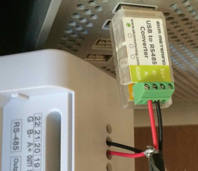

Here's a picture of the wiring. (Black wire jackets are nearly aligned.)

Yes, you should be able to get 100% good reads with this setup.
The first thing that jumps out at me is the wire you are using. It looks like a black shielded cable with 2 red wires and 2 black wires. It looks like the wires go from the meter through the black jacket then back through the jacket and to the USB converter.
What if you just replace this with a 24AWG twisted pair from a CAT5 cable? You should get 100% good meter reads.

I tried ~2 feet of speaker wire with the same results. The setup I took a picture of was using shielded twisted pair (one red, one black). In the picture the two ends of the ~15 foot cable were nearly aligned so they looked like one big cable.
I'll cut up an extra 1 meter Cat5 patch cord and try that. I don't expect any difference because cross-talk issues are minimal for the short lengths I'm using.

You have connected and disconnected your different wires enough times with the same results that I cant imagine it has something to do with the terminal block connection.
So that narrows it down to a USB issue, or a meter issue, or an issue with the Dash.
First try restarting the EKM Dash software, if this dosn't help restart your computer. I have seen an issue on a Mac before where every other read was good (not exactly what you are seeing), and I seem to recall it was fixed with a restart.

Restarting EKM Dash didn't make any difference. Restarting the computer WORKED!!
Perhaps it is important to restart after installing the USB driver?
