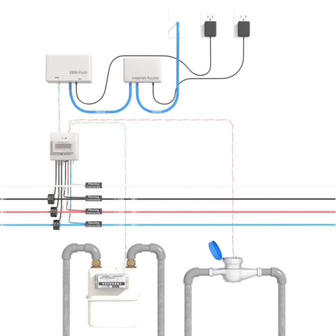

See this 3D diagram:

In order to connect your water meter to our EKM Push system, you will need to connect your water meter to and Omnimeter Pulse v.4, and then connect the Omnimeter Pulse v.4 to your EKM Push. Each Omnimeter Pulse v.4 can count the pulses from up to 3 water or gas meters.
