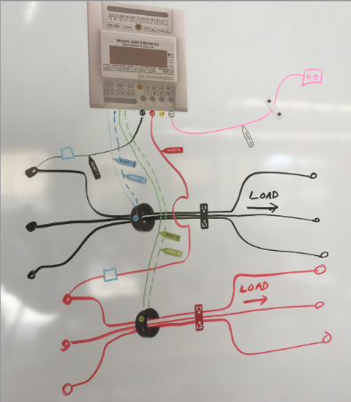

Yes I would also go with your "Preferred Option" I would locate the submeter near the panel and run multiple circuits through the same CT. You can combine multiple loads in the same Current Transformer provided that all wires going through a CT are on the same phase (otherwise they will cancel eachother out)
So I would physically combine the circuits for your Electric Space Heater, the lights, and the sockets. You will then connect the meter as a single phase 3-wire (2 hot wires and one Neutral wire) similar to these diagrams and instructions:
https://help.ekmmetering.com/support/so ... v-metering
Here is another diagram showing how multiple wires from the same phase can go through each CT:
Screenshot 2016-06-15 16.14.47.png (233.01 KiB) Viewed 12150 times
You can use any of our Omnimeters for this installation and you will need to buy 2 of our Current Transformers for this type of electrical system.
http://www.ekmmetering.com/120-240v-package.html
I would also consider a meter enclosure and an EKM Push system. Are you wanting to read this meter off of the LCD screen or would you like to be able to get your data remotely over the web?
Let me know if you have any further questions. Sorry about the file size upload limitation. I will look into it (I just had the same issue with the image above!)
