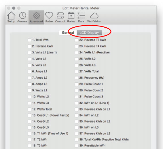

LCD Display? the User Manual shows that under Advanced settings for a specific meter, there are two tabs "General" & "LCD Display" and text that says to make the settings as to what data is displayed on the meter screen in the latter tab. I don't have that tab when I open DASH and choose to edit a meter. Is there another way to make those settings?

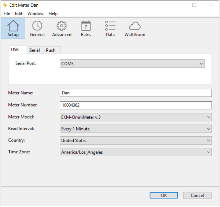

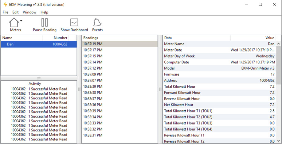

I wasn't connected to Push. I had DASH set to USB tab and had Blink plugged in and was getting readings.
images:
- showing that DASH is connected to meter
- showing that DASH is on USB tab

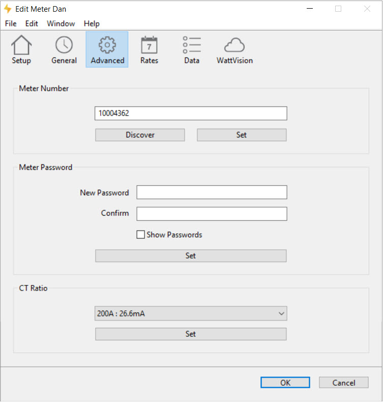

- showing that the LCD tab not there (nor is the General tab)

Thanks for getting back to us, and thanks for the further details and screenshots. This clears it up -- you have the Omnimeter I v.3, while the instructions for setting the display options pertain only to the more advanced Omnimeter Pulse v.4 models. As mentioned in the EKM Dash User Manual on page 7:
"The Omnimeter Pulse v.4 has the ability to change what displays on the meter’s LCD screen. To choose what you want to display, click the “LCD Display” tab and check the boxes next to the data values that you want to display on you meter’s screen. When you are ready, click “Set” to enter these settings in your meter."
The Omnimeter I v.3 is a different model that simply scrolls through its 15 different LCD display values, one at a time, while the more advanced Omnimeter Pulse v.4 has up to 42 different displays you can choose from.
